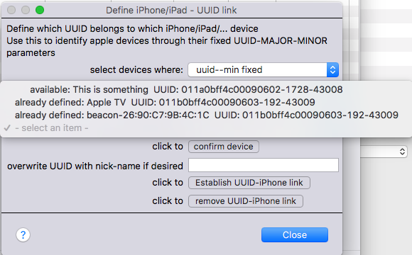

I'm having problems renaming my Apple TV beacon.
I've defined an iPhone/iPad UUID link of type uuid--min fixed, 18 char long (e.g. Apple TV), confirmed and established, etc.
Then I double-click the green beacon established above and change the device name from the mac address to Apple TV.
When I power cycle the Apple TV, I get a new beacon created and the old named Apple TV beacon remains in the list expired.
I am therefore not able to persistently have a beacon device named Apple TV
What's interesting is that when I go to associate the new device, it tells me that it is already defined: What may I be doing wrong?
- Screen Shot 2017-09-10 at 15.26.17.png (87.08 KiB) Viewed 3778 times

Could you do a print config and post the beacon sections.
Re: Apple TV is iBeacon
looked a bit into it.
one issue is timing.
the decision to map UUID-maj-min to a mac# is done on the RPIs.
the flow is the following:
1. check if map (uuid-mej-min selected with uuid-maj-min incoming) matches, if yes: replace newMAC # with predefined mac #
2. if uuid (first 10 char.) in uuid reject list: reject
3. if mac number in reject list : reject
reject list and map lists need to be ftp-ed to each mac.
(the reject list gets updated once an beacon device is deleted.the mac# of that beacon is added to the reject list. - you can reset that in menu (un)ignore beacons)
during the time when the files are not in sync some messages might come through that will not after all files are in sync.
one issue I see: if e.g. UUID and MIN stay always the same, but maj changes and you select uuid--min to be fixed / constant. Then the UUID-MAJ-MIN in the notes field will be changing with new MAJ #.
Q: should that happen or should MAJ be replaced with predefined MAJ?
Hackencrash. In order to analyze your setup I need the details of your beacons, all defined, old ones, and uuid-mac# mapping from print config..
I have some test cases and mine seem to work.
Hi Karl, sorry I haven't done the print configuration thing yet - VPN access from my small phone screen do do this would be painful - I'll do that tonight.
From remotely checking this, it does look like it has successfully updated, so yes perhaps it's a timing issue as I didn't realise the processing for this was done on the rPi's.
Will confirm later when I have a bigger screen!
