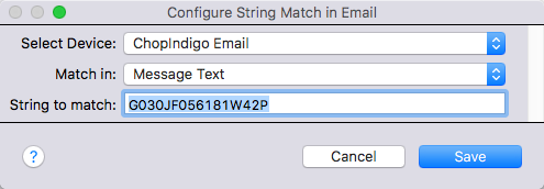

Finally got it successfully reading the incoming emails. (Turned off 2-step authentication in Gmail, deleted every existing email in the account, changed password, reconfigured plugin.)
My only remaining problem is the failure of the string match trigger, even though the specified text is clearly in the email.
Dec 5, 2016, 4:25:41 PM
   Better Email Debug              ChopIndigo Email: IDLE Event Received
   Better Email Debug              ChopIndigo Email: Doing checkMsgs
   Better Email Debug              ChopIndigo Email: msg_ids = ['1 2 3 4 5 6']
   Better Email Debug              ChopIndigo Email: Checking Message # 1
   Better Email Debug              ChopIndigo Email: Message # 1 already seen, skipping...
   Better Email Debug              ChopIndigo Email: Checking Message # 2
   Better Email Debug              ChopIndigo Email: Message # 2 already seen, skipping...
   Better Email Debug              ChopIndigo Email: Checking Message # 3
   Better Email Debug              ChopIndigo Email: Message # 3 already seen, skipping...
   Better Email Debug              ChopIndigo Email: Checking Message # 4
   Better Email Debug              ChopIndigo Email: Message # 4 already seen, skipping...

   Better Email Debug              Checking Triggers for Device ChopIndigo Email (1017660371)
   Better Email Debug              	Checking Trigger AWS Button #1 - Single Click (910245963), stringMatch
   Better Email Debug              	Checking Device State messageText for string: G030JF056181W42P
   Better Email Debug              	No Match for Trigger AWS Button #1 - Single Click (910245963)
Screenshot of the trigger's config:
Screenshot of the incoming email:
Re: Better Email Q&A
stringMatch is an exact match for the field. For a substring or pattern match, you need to use the regex trigger.
ChopOMatic

AHHHHHHH...
BOOM. Now playing both kinds of music: Rock AND roll!
Thx, Joe!

I now have an Amazon AWS IoT button integrated into my Indigo setup, thanks to Joe. I can trigger three different actions depending on whether I single-click, double-click, or long-click the button.
ChopOMatic wrote:I now have an Amazon AWS IoT button integrated into my Indigo setup, thanks to Joe. I can trigger three different actions depending on whether I single-click, double-click, or long-click the button.
Sweet.
PS - I just added a note to the Event Creation dialog box calling out that String Match is an exact match. Should have had that there before.
