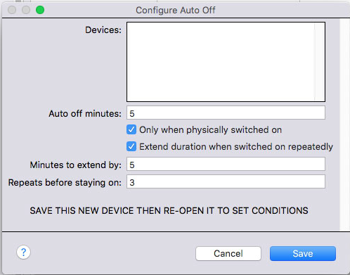

Loved the Powermiser plug-in, and have been using for some time now.
However, lately, it has ceased to function, and is no longer configurable. When I try adding a new auto-off device, the "Device" field is blank (see attachment), and I cannot proceed without being able to select a device to control.
I have removed the plug-in, reinstalled, re-synced all Indigo devices, to no avail.
Any help would be appreciated. Thank you.
– Kevin
– Kevin
- ishot-1.jpg (47.98 KiB) Viewed 6457 times

Re: Powermiser Plugin
I'll take a look this week at the release on the store, not sure why it would suddenly break on you. Did you change anything or upgrade?
You might try doing another fresh install with the following steps if you didn't take them all before.

I've found in some cases that the plugin preferences file can get into a bad state (this has happened to some of my plugins) and I've found that deleting the preferences file can set things right. An added bonus of recreating the preferences file is that it will ensure the preferences file itself is clean and up to date and reflects the latest configuration options only.
tl;dr: in some of my plugins, I write values to the preferences file on an interval basis--for example, poll intervals--which results in routine read/writes of the preferences file itself. I'm not sure, but I suspect that there are situations where a user opens or closes the configuration file at the same time that the plugin is trying to read from or write to it (and may be exacerbated depending on if/how Indigo caches the preferences file during these operations. This is not Indigo's fault and (regardless) I plan to move to a different architecture to try to eliminate this rare problem in the future.

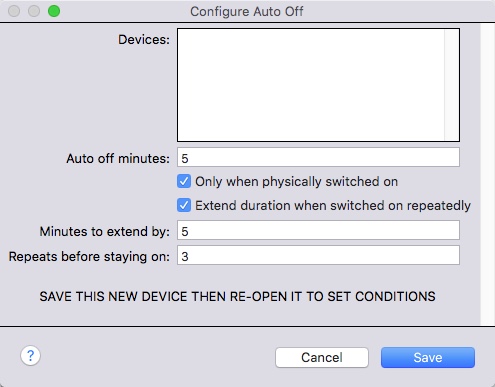

Hello,
I'm also having the same problem that Kevin is having.
I've also tried the below
Edmond
Any Ideas?You might try doing another fresh install with the following steps if you didn't take them all before.

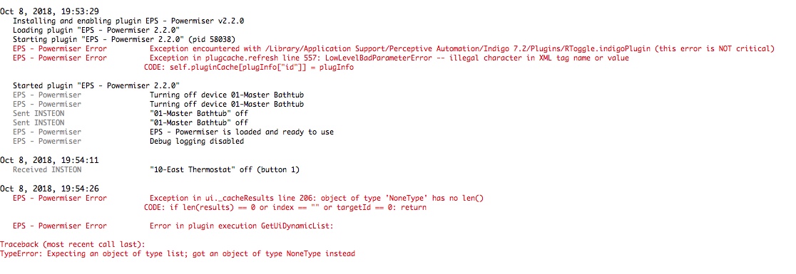

Not sure if this will help or not, however I get the following error when the Configure Auto Off window opens u.
Any ides?
Edmond
Any ides?
Edmond
Oct 7, 2018, 1:06:01 PM
EPS - Powermiser Error Exception in ui._cacheResults line 206: object of type 'NoneType' has no len()
CODE: if len(results) == 0 or index == "" or targetId == 0: return
EPS - Powermiser Error Error in plugin execution GetUiDynamicList:
TypeError: Expecting an object of type list; got an object of type NoneType insteadRe: Powermiser Plugin
As did Edmond, I tried the reinstall using the steps that DaveL17 suggested. The plug-in still does not populate the "Devices" field, so I have nothing to select.
I notice the following errors in the log when Powermiser was installed, however (see attachment).
I apologize for not responding sooner, I simply did not check the forum for a response until this week.
– Kevin
– Kevin
- ishot-1.jpg (120.99 KiB) Viewed 5942 times
"I'll take a look this week at the release on the store, not sure why it would suddenly break on you. Did you change anything or upgrade?"
In response from this earlier question: I did upgrade to Indigo 7, and then Indigo 7.2, but I can't pinpoint exactly when the plug-in stopped functioning.
What is also odd is I have several devices that were programmed to shut off using Powermiser before this failure of the plug-in was noticed. The plug-in still seems to be working with those devices (despite the missing "Devices" field). However, I can no longer program new devices, nor modify existing ones.
– Kevin
