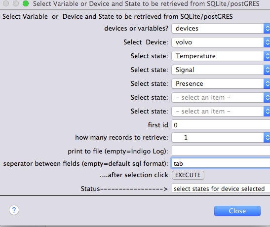

new version (0.7.3) posted where you can use the word "tab" to set the separator to tab, see screen shot
