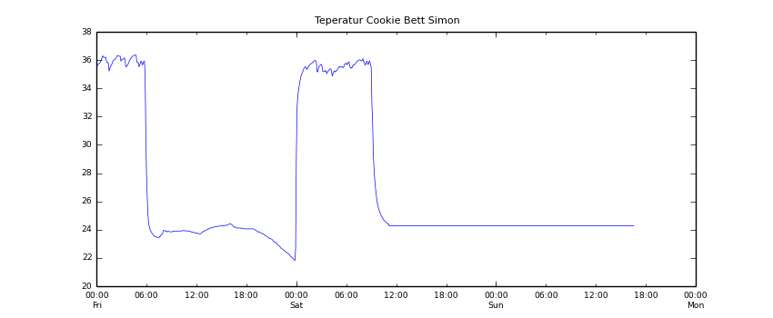

Well... :D it's just a trigger to set my variable "Night" true|false. (I use this variable to dim the lights during the night, set a shorter time to turnOff the lights after no movement was detected, hold the roller blinds closed ...)
This is my setup:
  • installed a cookie for each person under the pillow
  • mesured the temperature for this cokkies
  • plotted a graph to see, about witch temperature-change a person is in bed (see attachment)
  • wrote a litte python script
Trigger-Script:
I decided to trigger at 28° C
cookie = indigo.devices[493671864] # Cookie Bett Simon
temp = float(cookie.states["Temperature"])
varSleeping = indigo.variables[1832956215] # "SimonSleeping"
varNacht = indigo.variables[1270898724] # "Night"
if temp > 28:
	indigo.variable.updateValue(varSleeping, "true")
	indigo.variable.updateValue(varNacht, "true")
if temp < 28:
	indigo.variable.updateValue(varSleeping, "false")
The variable "Night" is set to true if one person is in bed – but it is only set to false if all persons are up. For that I set another variable "[NAME]Sleeping" for each person and if all variables are false, then the night-mode is turned off.

Very clever idea! I presume the cookie is not noticable when sleeping?

No, not at all
