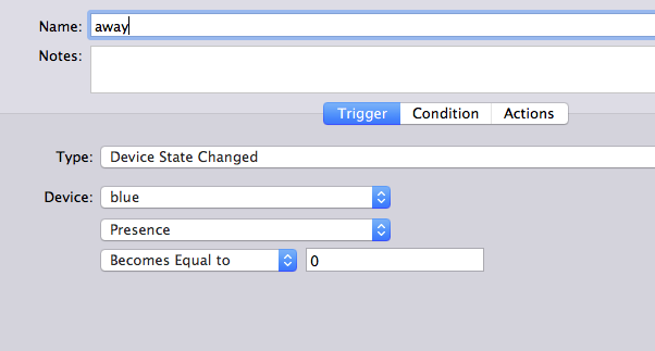

  • [fixed in 0.3.2] Triggers: There is a 'mother event' called 'Device is back home': how can I set which cookie to track? I do have one cookie for every family member...

as for the trigger see:
Screen Shot 2015-04-18 at 5.27.17 AM.png (26.82 KiB) Viewed 9238 times
setup 2 triggers for each cookie (away / home)
use 0 for away and 2 for present

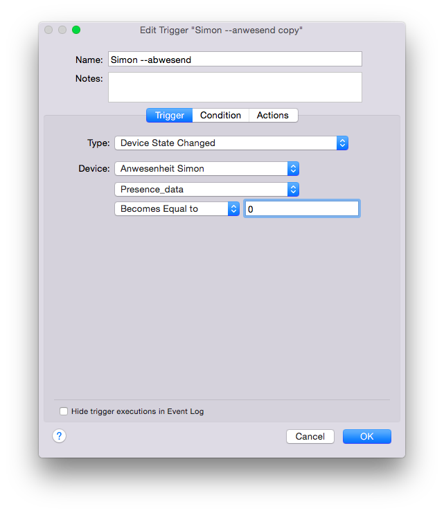

"Presence" is called "Presence_data" on my Indigo:
Bildschirmfoto 2015-04-18 um 12.41.31.png (65.85 KiB) Viewed 9238 times
Re: mother discussion
I changed that one in the new version, but it is active only for newly created devices.
funktioniert der Rest? Ich habe noch nicht die üä probiert..
you can check the hone/away process to the trigger by removing the battery from the cookie .. after ~ 3 minutes mother thinks you are gone. then put back the battery and after ~ 15 seconds it should go to home.

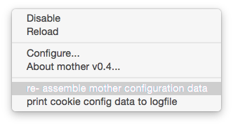

How can I force mother-plugin to re-initiate alle cookies? That does not help:
Bildschirmfoto 2015-04-19 um 09.29.07.png (26.15 KiB) Viewed 9161 times
the re- assemble does the following:
- query the sen.se web site for all cookies, then try to match to existing indigo devices.
If it has the cookie already in its config file, it tries to find an match in indigo: (a) indigo device # (b) indigo name or (c) cookie name. If it any of these match it assumes it is a cookie.
I will add to also match the device- model as a test not to match to existing other devices.
if no match it will try to create an indigo device with the name of the cookie.
To improve that I will add another test to see if cookie = indigo name but not the model create an indigo device with cookieName+"cookie", you then can change the indigo device name later.
As for the line 288 error . Either it is not a cookie device or the state name in your cookie device is wrong: delete the indigo cookie device and re-assemble. the Indigo device will be recreated with the proper state name
give me 1/2 a day. should be fixed this evening.
