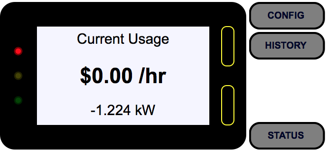

Separately, you'd previously asked me about energyInput2. That parameter doesn't appear. If you know the Eagle url that dumps out the xml data, I can see if it's sending it.
Also, I don't think you're expecting eagle to send you a negative value:
Eagle says: current usage is -0.099kW
>>> indigo.devices[133281462].states["energyInput1"]
4294967.0750000002
Thanks for the report. I'll fix the bug that causes Energy EAGLE to crash when there's no pricing information from the meter.
With regard to pricing: yes, my meter doesn't report any pricing information either. I've yet to see anyone report that their meter does actually. I suspect it's a supported feature of the ZigBee Smart Energy Profile specification which is why the EAGLE reports that data, but just not used by any of the energy companies (that I know of).
Actually, I was wanting to know about "accumEnergyTotal2" (there's no energyInput2 state). For me, the accumEnergyTotal2 state shows 0.
So, you're seeing a Current Load of -0.099 kW but the "energyInput1" device state is showing 4294967.0750000002? That doesn't seem possible as "Current Load" is the UI name given to the "energyInput1" device state. Can you double-check the "energyInput1" state value within the Indigo GUI client? It shouldn't report any number greater than around 20.000 kW. If it is, there's a major calculating error that I need to track down and the -0.099 you're seeing is more likely correct.

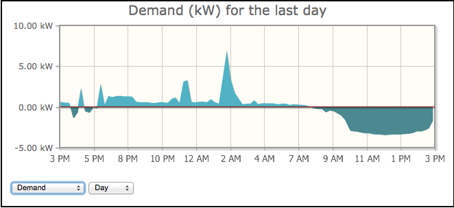

Yes, accumEnergy2 shows the amount of power sent to the grid. It corresponds exactly to the number shown on the eagle on its Meter Reading page.
The energyInput1 number corresponds to the energy usage shown on the eagle on the current usage page. When this number is positive, it's fine. But when it is negative (on the eagle screen), the indigo param is out of range.
Edit: also attached is what the demand curve looks like (also negative for sunny parts of the day), just so you can be aware of that :-)

Nice! Thanks for the screen shots. I definitely need debug logging info to fix that because the EAGLE API documentation doesn't describe how it handles negative demand values and all demand values are expressed in the XML output as 5 separate hexadecimal values (raw reading integer, multiplier integer, divisor integer, digits left integer, digits right integer), none of which indicate how to handle negative values. The method I'm using to convert the hex value to an integer is the Python built-in int() method. So I need to see exactly what hex values the EAGLE is giving you so I can reverse-engineer their negative demand calculation method.
If you get a chance while the demand value is a negative number, temporarily turn on debug logging (in the Energy EAGLE configuration) then turn it off. Your log will quickly be flooded with a lot of XML code (every 5 seconds to be exact). I think I'll just need one or two full XML dumps from that log.
Thanks for the help.

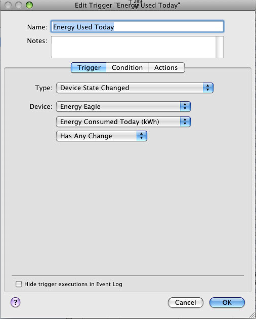

One last issue.
I am attempting to set up an action that updates a variable every time the "Energy Consumed Today" state changes.
I have enclosed a picture of the trigger window.
It looks like the value never changes; The trigger never fires.
If the trigger did fire, I used the variable actions plugin to insert the device state of "accumEnergyToday" into a variable.
Is it possible that the state of "Energy Consumed Today" isn't getting updated on the server ?
Thanks !
Mike
Screen Shot 2013-08-10 at 11.58.56 PM.png (91.27 KiB) Viewed 4478 times

asw24b wrote:Is it possible that the state of "Energy Consumed Today" isn't getting updated on the server ?
Yes. In fact, I doubt any device states are being updated if you're getting the errors you've reported.
For all the errors you guys have reported, I believe the new version 0.9.4 should fix them. However, since I can't completely reproduce your conditions, there may be new errors that pop up. Please let me know so I can trace them down and fix then as they appear. Thanks for the help guys!

asw24b
Posts: 222
Joined: Sun Dec 30, 2007 7:45 pm
Location: Los Altos Hills, CA
Re: Energy EAGLE Discussion
Post by asw24b »
asw24b wrote:
nsheldon wrote:
@asw24b: Thanks for the detailed errors and analysis. The
if localProps.get('macID', "0x0000000000000000") == "0x0000000000000000":
line is true when the Energy EAGLE device is first created because that property doesn't exist, so the "get" method returns the "0x000..." string instead, which makes the statement true. However, if for some reason the EAGLE or (more likely) the plugin saved something (even something invalid like an empty string) into the "macID" property, that statement would evaluate to false. I'm betting the first time you created the Energy EAGLE device in Indigo, the EAGLE wasn't paired with your meter. That caused the plugin to create the Energy EAGLE device, but use blank values for the device properties, and because the above test wasn't accounting for the macID property to be blank, it caused all kinds of data gathering errors (because the plugin was asking for data for a device with a blank MAC address).
I thought of that, so I deleted the device and created it again from scratch; Same result.
I modified the plug in to always update the MacID, and I added the pricing info. After that, it worked great, except that I couldn't get the variable to update (I didn't debug why).
Cool.
I'll try the new version.
Thanks !
Mike
No joy; The trigger still isn't firing.
I'll look into it more tomorrow...
Mike
nsheldon
Posts: 2469
Location: CA
Post by nsheldon »
asw24b wrote:No joy; The trigger still isn't firing.
Mike
Sorry to hear that. If you give me some debug log output that would be helpful.
asw24b
Posts: 222
Post by asw24b »
Mike
Here is what I (think) I have found so far; Apologies in advance if I missed something.
