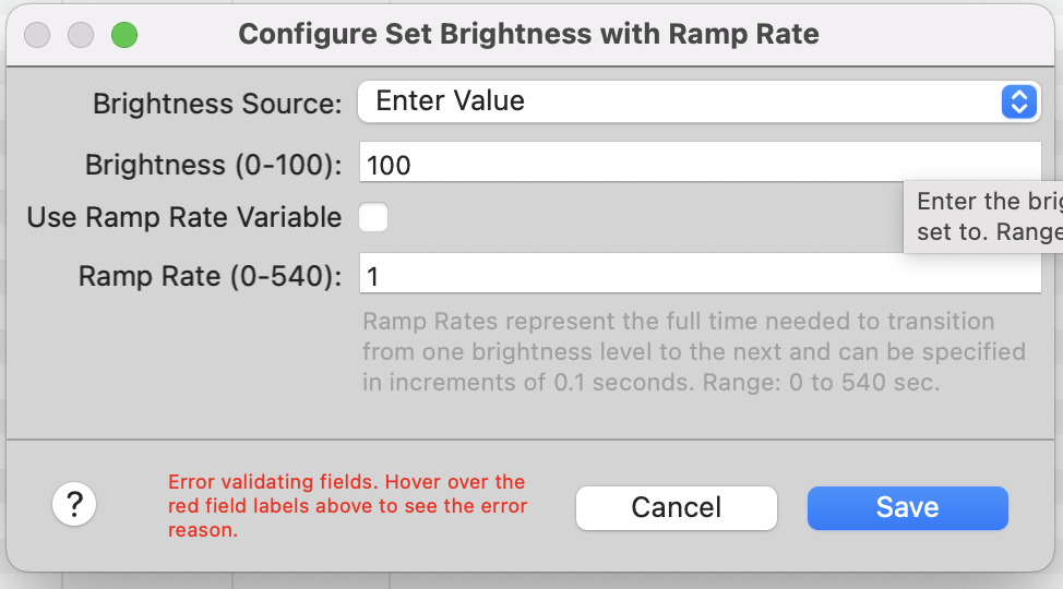

Maybe a bug introduced with the new version?
I set the brightness using the field, I do not want the brightness taken from a variable/other device.
Schermata 2022-02-07 alle 14.44.28.png (133.27 KiB) Viewed 3199 times

Re: Hue Lights discussion
I have the second fixed in v 1.8.1
Want test a little longer. Will post tomorrow.
is there anything in the log for the first post?
Karl.
please try:
https://github.com/nsheldon/Hue-Lights- ... tag/v1.8.1
should take care of both issues

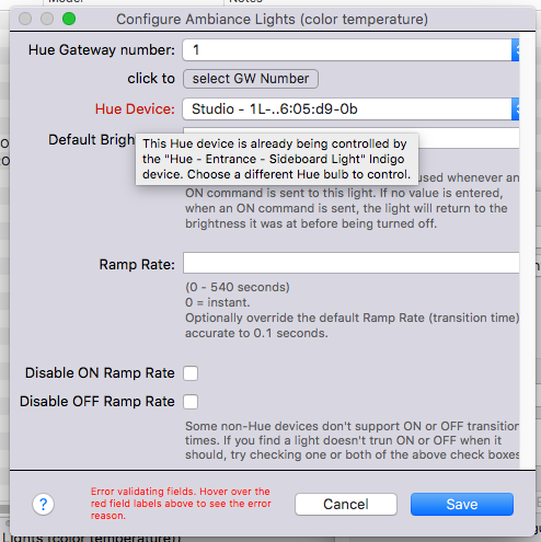

Seem to be having another little issue. I have 2 Hue Gateways. When I go to add a new device and choose light "x" from Gateway1, it says error: light "x" is already being controlled by an Indigo Device , but this is not true. Even if I delete light "x" from the Philips Hue app and re-add it fresh, I get the same error. When I go to the Indigo Device which the plugin thinks is controlling my new light, the plugin window continues to tell fibs by showing light "x" as selected, but the Indigo Device is actually controlling light "y", and light "y" is working perfectly normally. I'm baffled!
Screen Shot 2022-02-15 at 8.09.12 PM.png (93.3 KiB) Viewed 3072 times

Thanks for the report. Could you share debug logs showing this? In Indigo, go to Plugins -> Hue Lights -> Toggle Debugging then reload the plugin (Plugins -> Hue Lights -> Reload). Reproduce the error and share the logs in your reply (or a private message if the logs are too long to share in a post).
I know what it is:
it compares the hub bulb- ids and this can be the same for 2 indigo devices. hubs start their ids with #1 ...99 so you can have bulbID =5 on both hubs.
we/i need to add the check if hub# is the same
we need to add
 and valuesDict['hubNumber'] == otherDevice.pluginProps.get('hubNumber', 0)
to
if valuesDict['bulbId'] == otherDevice.pluginProps.get('bulbId', 0):
in several places
please check:
https://github.com/nsheldon/Hue-Lights- ... tag/v1.8.4
that should fix it.. and nathan could you move this to production?
Nathan,
had to do this fix in 10 places for bulbId , groupId, and sensorId
if valuesDict['bulbId'] == otherDevice.pluginProps.get('bulbId', 0) and hubNumber == otherDevice.pluginProps.get('hubNumber', 0)
if sensorId == otherDevice.pluginProps.get('sensorId', 0) and hubNumber == otherDevice.pluginProps.get('hubNumber', 0)
if valuesDict['groupId'] == otherDevice.pluginProps.get('groupId', 0) and hubNumber == otherDevice.pluginProps.get('hubNumber', 0):

You guys are amazing. Thank you for all the time & effort you put into these plugins. Problem solved!
