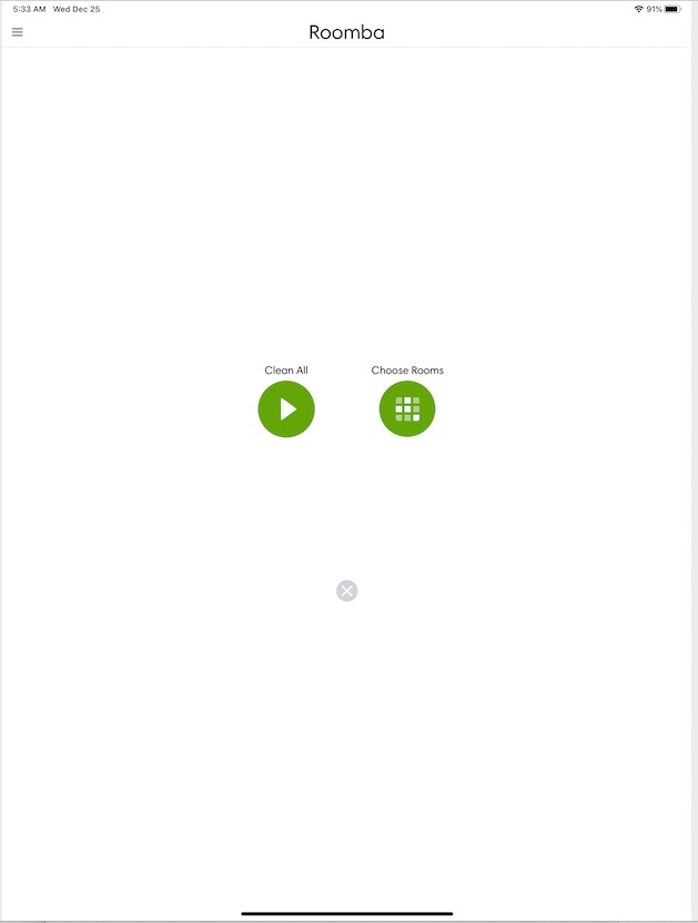

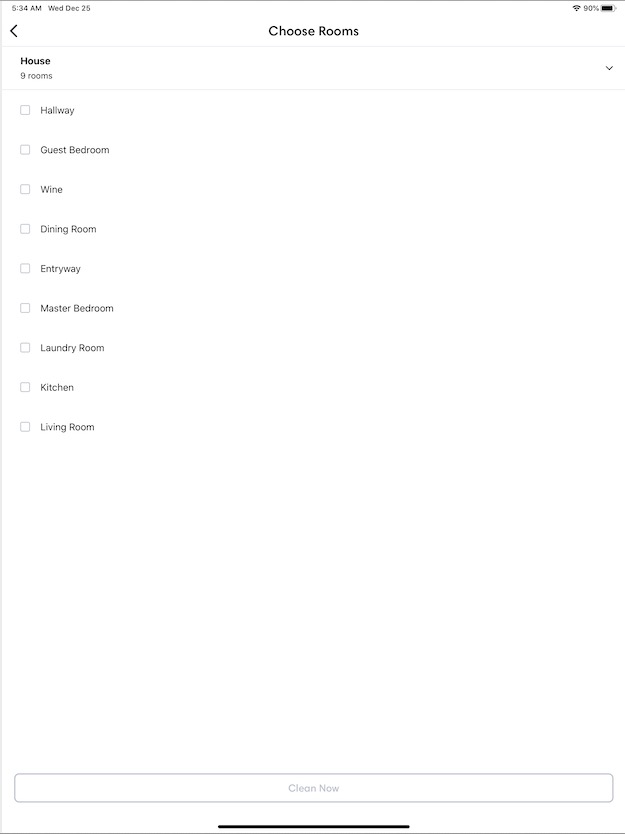

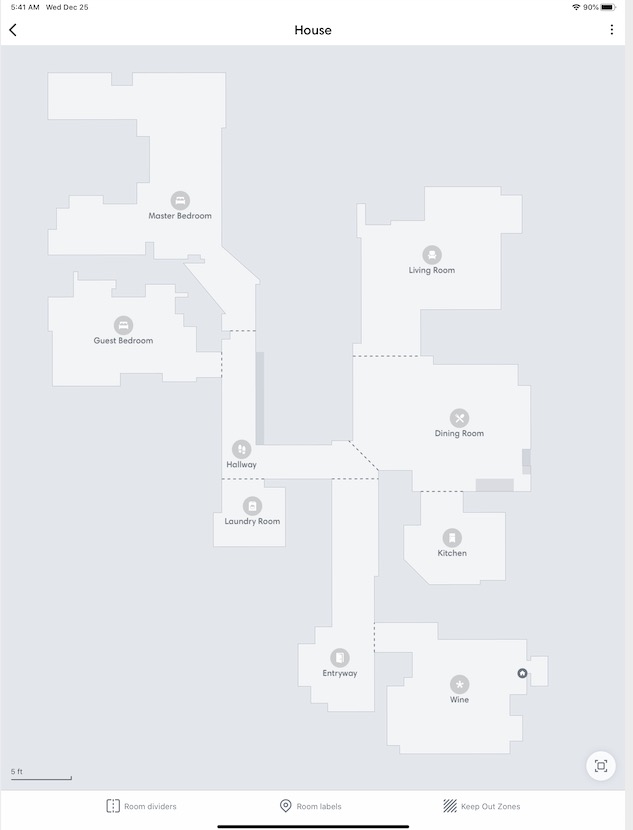

Happy holiday - Just FYI - the room stuff is available on the i7 as well (that is the version I got, with the external bin). If you select clean from the start page you are sent to a second page to select Clean All - or - select individual rooms from the list of rooms defined in roomba.
The vacuum does a great job and having it integrated with indigo would allow me to cycle through various rooms to vacuum whenever I'm not home. If you need any info from me to help with any efforts -- just let me know, happy to help!!!
