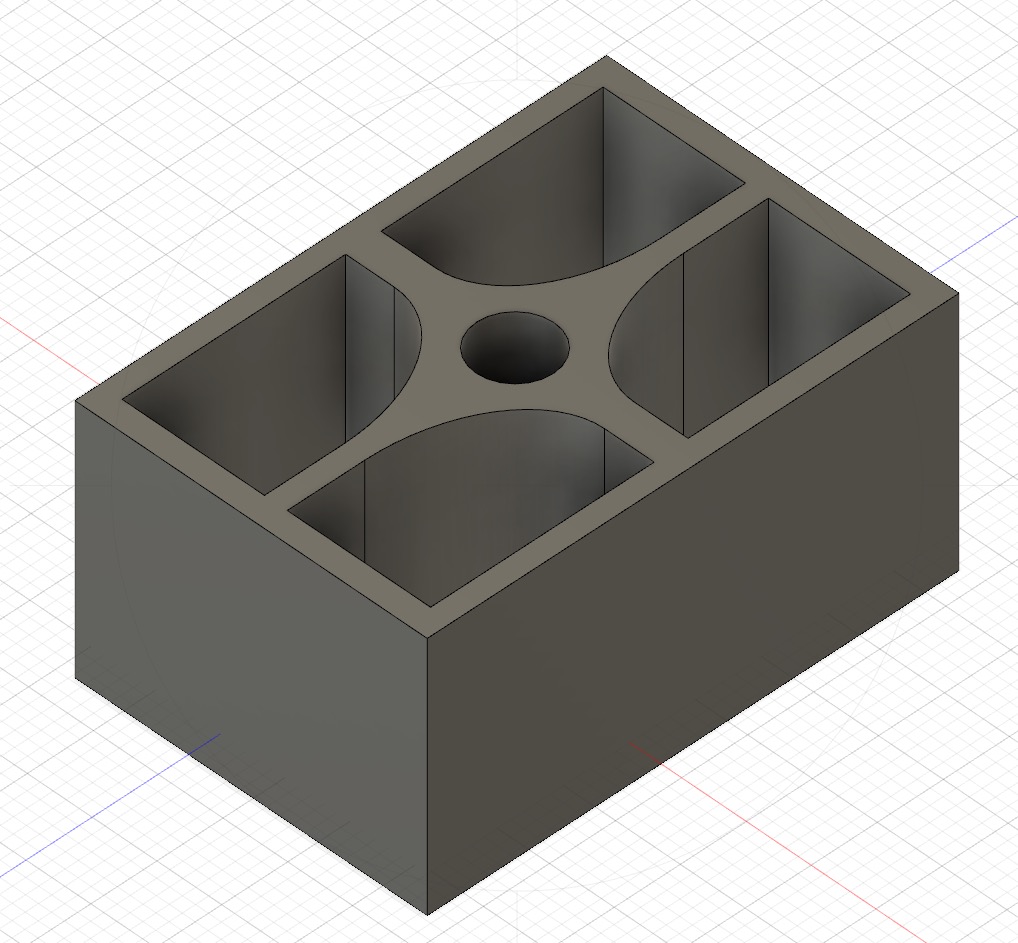

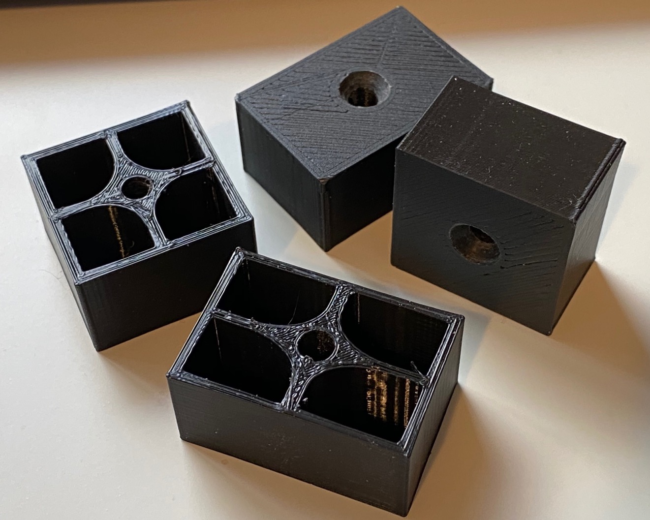

I was told by an elf that there is a roomba under the xmas tree - I have been making risers (on my 3d printer) for most of the furniture so roomba can vacuum under as much as possible.
Adding to mrmatt68's request, it would be fantastic if indigo could send roomba to individual rooms vice clean everything. This is possible from the roomba app and from alexa so hoping you will consider adding that capability to the plug-in.
In any case, happy holidays to all and if you see an elf -- a few cookies can lead to good info on what is under the tree
