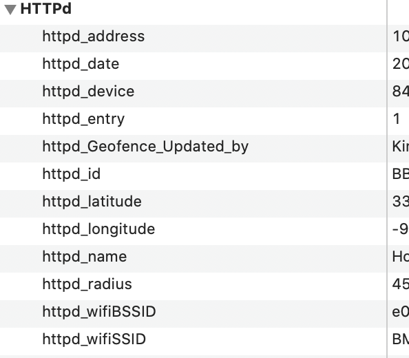

Re: HTTPd Plugin (useful for IFTTT Maker integration)
Hello FD,
Love your plugin, been using it since it came out.
I have a need to run 2 instances of HTTPd on separate ports. I am using Geofency for presence awareness. It has a built-in feature to define a webhook when you pass through different geofences and can make direct GET's to HTTPd. Having said that, GEOFency is being run on two phones at the same time and I need a way for each phone to have its own instance of HTTPd to post to. Timing issues arise if both phones try to make calls to the same HTTPd at the same time. They step all over each other, so having an HTTPd per phone will solve my issues.
One issue would be each HTTPd instance would need its own variable prefix's so they don't mix with each other. Attached is a screenshot of all the variables one event can post to HTTPd. And there is no way to specify a prefix for each phone.
Thoughts?
Thoughts?

- Posts: 7830
I can do that. If I support multiple "instances", then it's just as easy to put the values into device states rather than variables. That is, you would create a device for http on port 5555 (for example), and another on port 5577. Then instead of having multiple sets of variables, each device would have their own states, which would replace the variables. Would that work?

JaceJenkins
- Posts: 59
- Joined: Fri Oct 16, 2015 6:41 am
Yeah, that would be perfect. I assume the states are dynamically created based values in the POST? So when GeoFency posts all the values to the webhook, those would all get created as states if they don't already exist?
You are awesome btw.
- Posts: 7830
Yes, exactly. I already do that in several other plugins.JaceJenkins wrote:Yeah, that would be perfect. I assume the states are dynamically created based values in the POST? So when GeoFency posts all the values to the webhook, those would all get created as states if they don't already exist?
