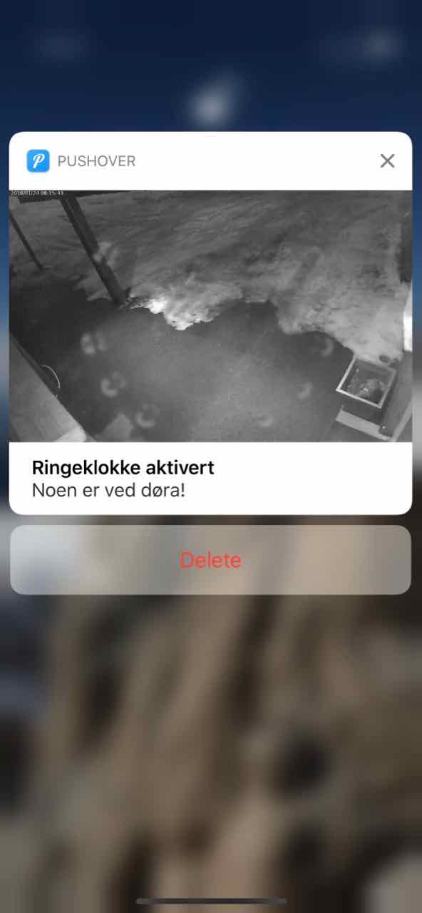

I played a bit with the email to notification feature. It looks nice, but it is a bit to slow to be used for door bell camera in my opinion.
But if implemented directly in the pushover plugin I assume it would be faster...
- IMG_0195.jpg (30.76 KiB) Viewed 6477 times
