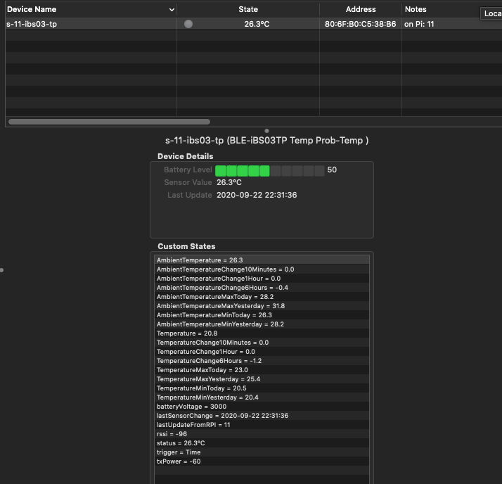

just in case you missed that.. with the demise of wireless RFXcom pool temperature devices, here the first real alternative I found:
iBS03TP is a water tight temp sensor that has also an external temp sensor,
You could either place it outside the pool and let the probe hang into the pool, or put the device onto a pice of wood or anything that swims and let the external sensor hanging into the water.
It is a bluetooth sensor. It broadcasts updates every 30 secs. Similar to the ruuvitag sensor.
Fully supported by piBeacon. Temperature = temp in the sensor, ambient -= temp in the probe, battery level is calculated from the battery Voltage (0=2900mV, 100=3150mV+)
Screen Shot 2020-09-22 at 22.43.57.png (73.05 KiB) Viewed 7213 times
You can get it from https://www.beaconzone.co.uk/sensor/iBS03TP or from alibaba : https://ingics.en.alibaba.com/product/6 ... probe.html
The battery should last for several month (web sites claim 2.5Y) it is a larger CR2450
and yes our pool is at 26C = 80F w/o heater .. one of the few the advantages of living in Dallas

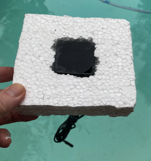

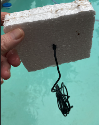

And some picture how to do a floating pool temperature sensor with the iBS03TP w 2 Styrofoam plates glued together. The top part has the sensor cut out, the probe cable runs through the bottom part. As it is 2 meter long it is curled up so the at the señor is ~ 20cm under water..

And you should dip the metal end of the probe into "liquid tape" to make it not touch the chlorinated water directly
And the device as a whole is IP67: "it has been tested to work for at least 30 minutes while under 15cm to 1m of water. "
ps and you can set the sensor indicator to green/grey/red depending on temperature. set it in device edit( and when ever indigo offers more colors like blue for cold it will be added too)

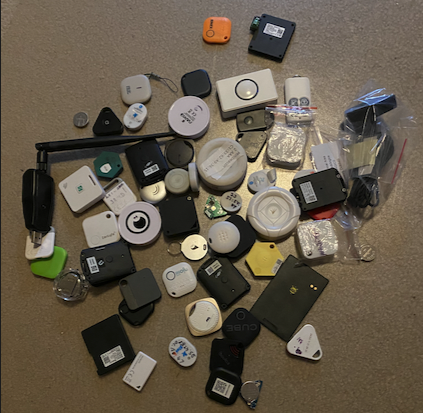

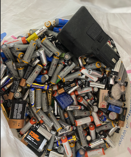

3 years of beacon etc testing

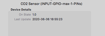

Second, I'm trying to reset the CO2 sensor, it's hanging in "HIGH".
I've tried to do one of the "manage sensor devices", but it's still on "HIGH".
How can I bring to back to "LOW"?

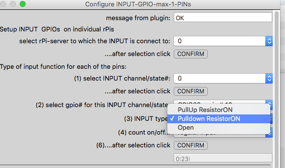

1. it should be piU, will post a fix later today
2. GPIO high .. I just tried mine, that works, could you post the device edit screen.. remember you need to first set each section, then confirm ... before you go to the next

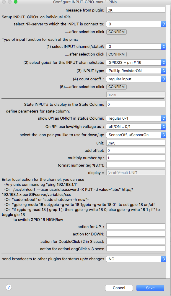

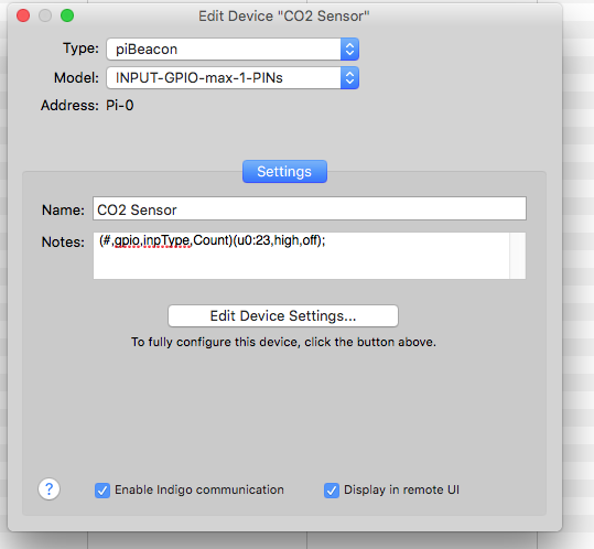

See screenshot of the "edit settings" of the sensor.
I have to say, that the sensor worked, one day with an update (can't remember when), the device was set to HIGH (the CO2 level wasn't critical) and since then it is staying on HIGH.
Can't reset it.
Yassi

You need to click on confirm then the next part is visible. There you set high low

Now, in which field(s)?
Bildschirmfoto 2020-10-11 um 15.47.24.png (178.92 KiB) Viewed 7009 times
Pull up resistor or down or off
Is high low off
yassi

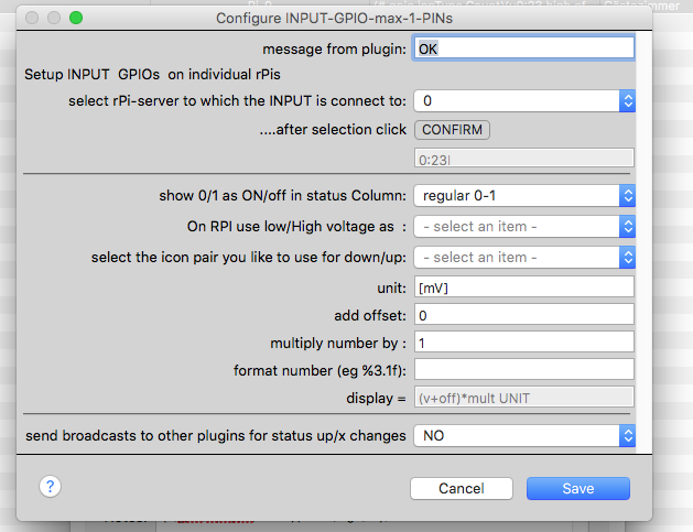

Nothing happens. Clicked on "Confirm"
The state is also old. Since then it stays on HIGH.
