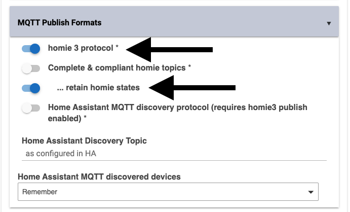

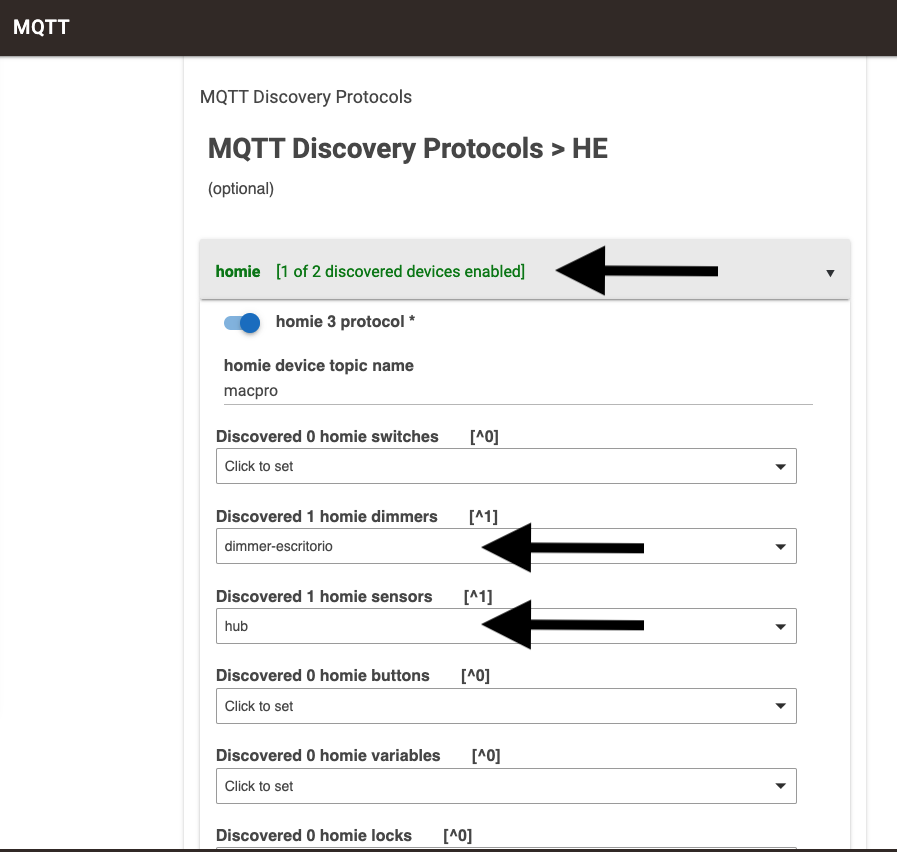

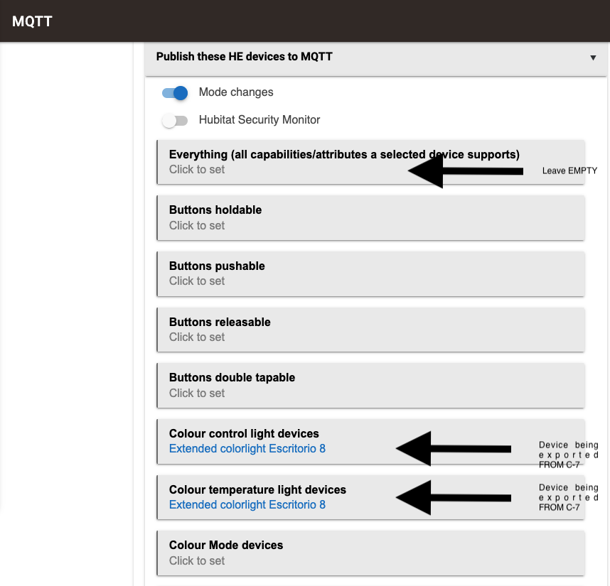

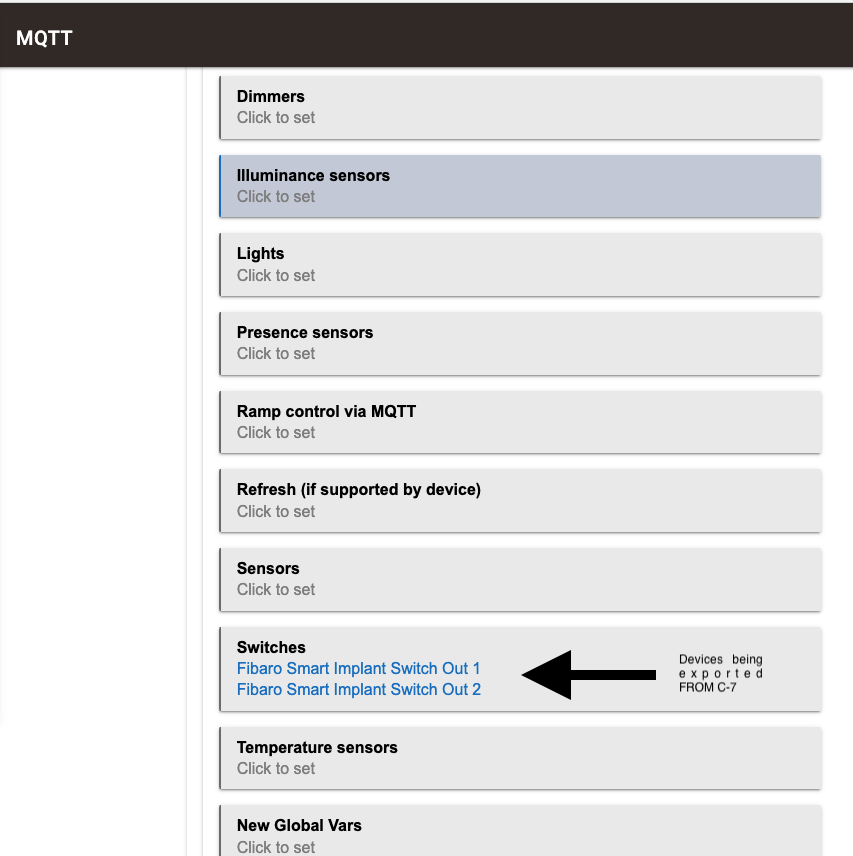

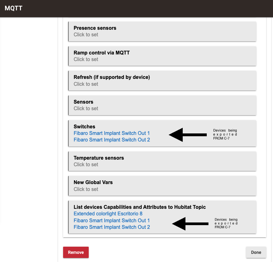

MQTT filtered section:
app:652022-01-23 12:39:25.876 pm debugMQTT: Received a dim event from dimmer-escritorio level 80 is macpro
app:652022-01-23 12:39:25.817 pm debugMQTT: Got dimmer-escritorio [2] [level, switch]
app:652022-01-23 12:38:50.186 pm debugMQTT: Got dimmer-escritorio [2] [level, switch]
app:652022-01-23 12:38:50.119 pm debugMQTT: Received a dim event from dimmer-escritorio level 0 is macpro
app:652022-01-23 12:35:55.993 pm debugMQTT: Received a dim event from dimmer-escritorio level 80 is macpro
app:652022-01-23 12:35:55.934 pm debugMQTT: Got dimmer-escritorio [2] [level, switch]
app:652022-01-23 12:35:31.093 pm debugMQTT: Got dimmer-escritorio [2] [level, switch]
app:652022-01-23 12:35:31.019 pm debugMQTT: Received a dim event from dimmer-escritorio level 0 is macpro
app:652022-01-23 12:34:57.841 pm infoMQTT: ================== Startup complete ==================
app:652022-01-23 12:34:57.660 pm infoMQTT: Unsubscribing HA events
app:652022-01-23 12:34:57.654 pm infoMQTT:     Imported [1] homie sensor devices of [1] discovered
app:652022-01-23 12:34:57.649 pm infoMQTT:     Imported [1] homie dim devices of [1] discovered
app:652022-01-23 12:34:57.643 pm infoMQTT:     [5]  Total Hubitat endpoints enabled on MQTT
app:652022-01-23 12:34:57.641 pm infoMQTT:     [4]  Total Hubitat devices are enabled on MQTT
app:652022-01-23 12:34:57.615 pm infoMQTT: ==================================================
app:652022-01-23 12:34:57.407 pm infoMQTT: Created Child device with label hub
app:652022-01-23 12:34:57.310 pm warnMQTT: Creating type sensor as  + (default) RM Connector Variable named MQTT:hub hub
app:652022-01-23 12:34:57.308 pm warnMQTT: Got a sensor of type default
app:652022-01-23 12:34:57.306 pm infoMQTT: [homie] Device enabled: homie hub : sensor default
app:652022-01-23 12:34:57.195 pm infoMQTT: [homie] Device enabled: homie dimmer-escritorio : dim default
app:652022-01-23 12:34:57.036 pm infoMQTT: Skipping HA stateStream MQTT discovery
app:652022-01-23 12:34:57.034 pm infoMQTT: Starting HA Discovery
app:652022-01-23 12:34:56.869 pm infoMQTT: ======= homie Discovery has completed in 1 secs =======
app:652022-01-23 12:34:56.771 pm debugMQTT: Received a dim event from dimmer-escritorio level 80 is macpro
app:652022-01-23 12:34:56.678 pm debugMQTT: Received a dim event from dimmer-escritorio level 80 is macpro
app:652022-01-23 12:34:56.290 pm debugMQTT: Got dimmer-escritorio [2] [level, switch]
app:652022-01-23 12:34:56.201 pm debugMQTT: Got dimmer-escritorio [2] [level, switch]
app:652022-01-23 12:34:56.136 pm debugMQTT: Got dimmer-escritorio [2] [level, switch]
app:652022-01-23 12:34:56.071 pm debugMQTT: Got dimmer-escritorio [2] [level, switch]
app:652022-01-23 12:34:56.026 pm infoMQTT: Initialize exit
app:652022-01-23 12:34:55.955 pm debugMQTT: Received a dim event from dimmer-escritorio level 80 is macpro
app:652022-01-23 12:34:55.901 pm infoMQTT: Adding homie name subscription topics
app:652022-01-23 12:34:55.880 pm infoMQTT: Adding homie property and node subscription topics for macpro
app:652022-01-23 12:34:55.864 pm infoMQTT: Adding homie onoff & dim events subscription topics
app:652022-01-23 12:34:55.848 pm infoMQTT: Subscribing to 2 individual device topics
app:652022-01-23 12:34:55.837 pm infoMQTT: Starting homie Discovery
app:652022-01-23 12:34:55.753 pm infoMQTT: HE device publishing to MQTT has completed in 0 secs
app:652022-01-23 12:34:55.090 pm infoMQTT: Extended colorlight Escritorio 8 [cMode] > [color-mode] publish topics BLOCKED
app:652022-01-23 12:34:55.084 pm debugMQTT: Got a colour synch Extended colorlight Escritorio 8 cMode CT
app:652022-01-23 12:34:55.079 pm warnMQTT: State was null so didn't update MQTT for homie/hubitatc7/extended-colorlight-escritorio-8
app:652022-01-23 12:34:55.059 pm warnMQTT: State had a null value for Extended colorlight Escritorio 8 colorName
app:652022-01-23 12:34:55.057 pm debugMQTT: Got a colour synch Extended colorlight Escritorio 8 colorName null
app:652022-01-23 12:34:54.986 pm debugMQTT: Got a colour synch Extended colorlight Escritorio 8 colorTemperature 6536
app:652022-01-23 12:34:54.979 pm warnMQTT: State was null so didn't update MQTT for homie/hubitatc7/extended-colorlight-escritorio-8
app:652022-01-23 12:34:54.957 pm warnMQTT: State had a null value for Extended colorlight Escritorio 8 colorName
app:652022-01-23 12:34:54.955 pm debugMQTT: Got a colour synch Extended colorlight Escritorio 8 colorName null
app:652022-01-23 12:34:54.873 pm debugMQTT: Got a colour synch Extended colorlight Escritorio 8 hsv [8, null, 65]
app:652022-01-23 12:34:54.861 pm infoMQTT: Resynch MQTT device states and HA discovery topics
app:652022-01-23 12:34:54.790 pm infoMQTT: Starting HE device publishing to MQTT for 4 HE devices with 9 attributes
app:652022-01-23 12:34:54.769 pm debugMQTT: Capability [Refresh][Switch] not required for device [Fibaro Smart Implant Switch Out 1]
app:652022-01-23 12:34:54.765 pm debugMQTT: Events subscribe to Fibaro Smart Implant Switch Out 1 switch switched
app:652022-01-23 12:34:54.764 pm debugMQTT: Fibaro Smart Implant Switch Out 1: Need to subscribe to events from Switch  switch using switched
app:652022-01-23 12:34:54.729 pm debugMQTT: Capability [Actuator][Switch] not required for device [Fibaro Smart Implant Switch Out 1]
app:652022-01-23 12:34:54.727 pm debugMQTT: Capability [Refresh][Switch] not required for device [Fibaro Smart Implant Switch Out 2]
app:652022-01-23 12:34:54.723 pm debugMQTT: Events subscribe to Fibaro Smart Implant Switch Out 2 switch switched
app:652022-01-23 12:34:54.721 pm debugMQTT: Fibaro Smart Implant Switch Out 2: Need to subscribe to events from Switch  switch using switched
app:652022-01-23 12:34:54.683 pm debugMQTT: Capability [Actuator][Switch] not required for device [Fibaro Smart Implant Switch Out 2]
app:652022-01-23 12:34:54.674 pm debugMQTT: Capability [Switch][ColorTemperature] not required for device [Extended colorlight Escritorio 8]
app:652022-01-23 12:34:54.672 pm debugMQTT: Capability [Light][ColorTemperature] not required for device [Extended colorlight Escritorio 8]
app:652022-01-23 12:34:54.671 pm debugMQTT: Capability [SwitchLevel][ColorTemperature] not required for device [Extended colorlight Escritorio 8]
app:652022-01-23 12:34:54.668 pm debugMQTT: Capability [ChangeLevel][ColorTemperature] not required for device [Extended colorlight Escritorio 8]
app:652022-01-23 12:34:54.666 pm debugMQTT: Capability [ColorControl][ColorTemperature] not required for device [Extended colorlight Escritorio 8]
app:652022-01-23 12:34:54.664 pm debugMQTT: Capability [ColorMode][ColorTemperature] not required for device [Extended colorlight Escritorio 8]
app:652022-01-23 12:34:54.660 pm debugMQTT: Events subscribe to Extended colorlight Escritorio 8 colorName colourDevices
app:652022-01-23 12:34:54.659 pm debugMQTT: Extended colorlight Escritorio 8: Need to subscribe to events from ColorTemperature  colorName using colourDevices
app:652022-01-23 12:34:54.640 pm debugMQTT: Events subscribe to Extended colorlight Escritorio 8 colorTemperature colourDevices
app:652022-01-23 12:34:54.638 pm debugMQTT: Extended colorlight Escritorio 8: Need to subscribe to events from ColorTemperature  colorTemperature using colourDevices
app:652022-01-23 12:34:54.610 pm debugMQTT: Capability [Refresh][ColorTemperature] not required for device [Extended colorlight Escritorio 8]
app:652022-01-23 12:34:54.608 pm debugMQTT: Capability [Actuator][ColorTemperature] not required for device [Extended colorlight Escritorio 8]
app:652022-01-23 12:34:54.605 pm debugMQTT: Capability [Switch][ColorControl] not required for device [Extended colorlight Escritorio 8]
app:652022-01-23 12:34:54.604 pm debugMQTT: Capability [Light][ColorControl] not required for device [Extended colorlight Escritorio 8]
app:652022-01-23 12:34:54.602 pm debugMQTT: Capability [SwitchLevel][ColorControl] not required for device [Extended colorlight Escritorio 8]
app:652022-01-23 12:34:54.600 pm debugMQTT: Capability [ChangeLevel][ColorControl] not required for device [Extended colorlight Escritorio 8]
app:652022-01-23 12:34:54.595 pm debugMQTT: Events subscribe to Extended colorlight Escritorio 8 RGB colourDevices
app:652022-01-23 12:34:54.593 pm debugMQTT: Extended colorlight Escritorio 8: Need to subscribe to events from ColorControl  RGB using colourDevices
app:652022-01-23 12:34:54.574 pm debugMQTT: Events subscribe to Extended colorlight Escritorio 8 colorName colourDevices
app:652022-01-23 12:34:54.572 pm debugMQTT: Extended colorlight Escritorio 8: Need to subscribe to events from ColorControl  colorName using colourDevices
app:652022-01-23 12:34:54.539 pm debugMQTT: Events subscribe to Extended colorlight Escritorio 8 color colourDevices
app:652022-01-23 12:34:54.538 pm debugMQTT: Extended colorlight Escritorio 8: Need to subscribe to events from ColorControl  color using colourDevices
app:652022-01-23 12:34:54.527 pm debugMQTT: Events subscribe to Extended colorlight Escritorio 8 saturation colourDevices
app:652022-01-23 12:34:54.526 pm debugMQTT: Extended colorlight Escritorio 8: Need to subscribe to events from ColorControl  saturation using colourDevices
app:652022-01-23 12:34:54.495 pm debugMQTT: Events subscribe to Extended colorlight Escritorio 8 hue colourDevices
app:652022-01-23 12:34:54.493 pm debugMQTT: Extended colorlight Escritorio 8: Need to subscribe to events from ColorControl  hue using colourDevices
app:652022-01-23 12:34:54.455 pm debugMQTT: Capability [ColorMode][ColorControl] not required for device [Extended colorlight Escritorio 8]
app:652022-01-23 12:34:54.453 pm debugMQTT: Capability [ColorTemperature][ColorControl] not required for device [Extended colorlight Escritorio 8]
app:652022-01-23 12:34:54.452 pm debugMQTT: Capability [Refresh][ColorControl] not required for device [Extended colorlight Escritorio 8]
app:652022-01-23 12:34:54.450 pm debugMQTT: Capability [Actuator][ColorControl] not required for device [Extended colorlight Escritorio 8]
app:652022-01-23 12:34:54.441 pm debugMQTT: deviceSubscribes
app:652022-01-23 12:34:53.642 pm debugMQTT: Initializing...
app:652022-01-23 12:34:53.641 pm warnMQTT: The published homie topic tree has been simplified in content and is no longer homie3 compliant
app:652022-01-23 12:34:43.612 pm infoMQTT: MQTT has reconnected, restarting APP
app:652022-01-23 12:34:43.599 pm infoMQTT: MQTT reports status of Connect
app:652022-01-23 12:34:42.061 pm infoMQTT: Waiting for MQTT connection: false
app:652022-01-23 12:34:41.956 pm infoMQTT: initialising with App count 0
app:652022-01-23 12:34:41.919 pm infoMQTT: Hubitat hub name is : hubitatc7
app:652022-01-23 12:34:41.909 pm infoMQTT: MQTT Client driver present
app:652022-01-23 12:34:41.874 pm infoMQTT: MQTT Updated
app:652022-01-23 12:33:58.101 pm debugMQTT: Received a dim event from dimmer-escritorio level 80 is macpro
app:652022-01-23 12:33:58.043 pm debugMQTT: Got dimmer-escritorio [2] [level, switch]
app:652022-01-23 12:33:53.650 pm debugMQTT: Got dimmer-escritorio [2] [level, switch]
app:652022-01-23 12:33:53.577 pm debugMQTT: Received a dim event from dimmer-escritorio level 0 is macpro
app:652022-01-23 12:33:45.459 pm debugMQTT: Received a dim event from dimmer-escritorio level 80 is macpro
app:652022-01-23 12:33:45.401 pm debugMQTT: Got dimmer-escritorio [2] [level, switch]
app:652022-01-23 12:33:42.366 pm debugMQTT: Got dimmer-escritorio [2] [level, switch]
app:652022-01-23 12:33:42.287 pm debugMQTT: Received a dim event from dimmer-escritorio level 0 is macpro
app:652022-01-23 12:31:17.148 pm debugMQTT: Received a dim event from dimmer-escritorio level 80 is macpro
app:652022-01-23 12:31:17.089 pm debugMQTT: Got dimmer-escritorio [2] [level, switch]
app:652022-01-23 12:30:49.094 pm debugMQTT: Got dimmer-escritorio [2] [level, switch]
app:652022-01-23 12:30:49.019 pm debugMQTT: Received a dim event from dimmer-escritorio level 0 is macpro
app:652022-01-23 12:30:34.605 pm debugMQTT: Received a dim event from dimmer-escritorio level 80 is macpro
app:652022-01-23 12:30:34.538 pm debugMQTT: Got dimmer-escritorio [2] [level, switch]
app:652022-01-23 12:28:02.624 pm debugMQTT: Got dimmer-escritorio [2] [level, switch]
app:652022-01-23 12:28:02.554 pm debugMQTT: Received a dim event from dimmer-escritorio level 0 is macpro
app:652022-01-23 12:27:59.958 pm debugMQTT: Received a dim event from dimmer-escritorio level 80 is macpro
app:652022-01-23 12:27:59.896 pm debugMQTT: Got dimmer-escritorio [2] [level, switch]
app:652022-01-23 12:27:11.791 pm debugMQTT: Got dimmer-escritorio [2] [switch, level]
app:652022-01-23 12:27:11.707 pm debugMQTT: Received a dim event from dimmer-escritorio level 0 is macpro
app:652022-01-23 12:26:51.510 pm debugMQTT: Received a dim event from dimmer-escritorio level 80 is macpro
app:652022-01-23 12:26:51.398 pm debugMQTT: Got dimmer-escritorio [2] [switch, level]
app:652022-01-23 12:22:19.519 pm infoMQTT: ================== Startup complete ==================

Here is my MQTT App config, in case something is different from yours:
DISCLAIMER: I HATE the way this forum software deals with attachments. I can NEVER get it right the first time. Sorry if that adds to the confusion.
THIRD (did I mention I HATE this forum attachment thing???) screen grab shows something that made me almost loose the rest of my (very little) remaining hair Yesterday. It's strange because it refers to the HE > other system side of things, but I could not have Indigo > HE Discovery working until I unselected all devices from there.
Additionally, if you are manually defining your Virtual Devices from OUTSIDE of the xAPPO/MQTT App, i've read from the more then 800 posts in both MQTT App beta threads that you should not, as automatic discovery won't pickup if the owner of the devices is not MQTT Child Device.

Thanks for the screen shots. I think mine is very similar.
I have now run out of time to work on this today. I will take another look at it tomorrow and do a double check. :)

No problem, just review my last post again tomorrow, as I had to make some edits to it, because this forum software sucks when it comes to attachments placement and sometimes repeats images. (second image was never meant to appear as it's the same as first. Could not remove it myself...
Also, Please do not get yourself confused by the "dimmer-escritorio" and "Extended Colour Light Escritorio 8" as the names may imply they are the same thing,
They are not, dimmer-escritorio is the one I'm trying to IMPORT from Indigo into HE. (still only working if I set on/off/brightness from Indigo and it reflects in the virtual device in HE, not the other way around). Sent message to Kevin in the Hubitat Forum but he seems to be MIA for the last couple of months...
Second is a different Hue bulb I'm EXPORTING from HE to Indigo. (fully working both ways).
Best regards and thanks again for coming to my rescue.
EDIT: If you are adding the topics manually to Mosquitto, do not forget to set QOS=1 and RETAIN = True.
