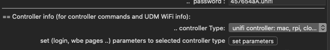

Re: uniFi WiFi AP: download
posted v7.30.246
for UDM/UDMpro/std controller type
To ease the confusion, in plugin config a button (set parameters) was added that should cover 90% of the config changes between
std / UDM / UDM pro settings will be set to the default settings for these controller types ie:
unifiCloudKeyMode
unifiCloudKeyPort
unifiApiLoginPath
unifiApiWebPage
ControllerBackupPath
UDM on off
You still can change any parameter to your liking
no functionality changes
unifiCloudKeyMode
unifiCloudKeyPort
unifiApiLoginPath
unifiApiWebPage
UDM on off
