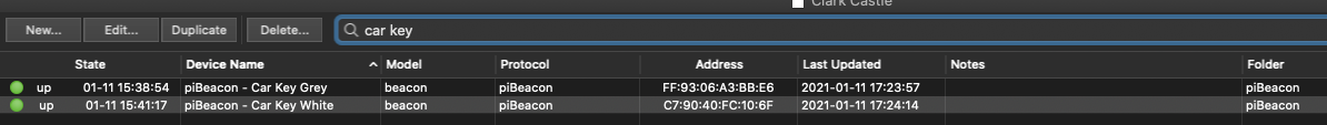

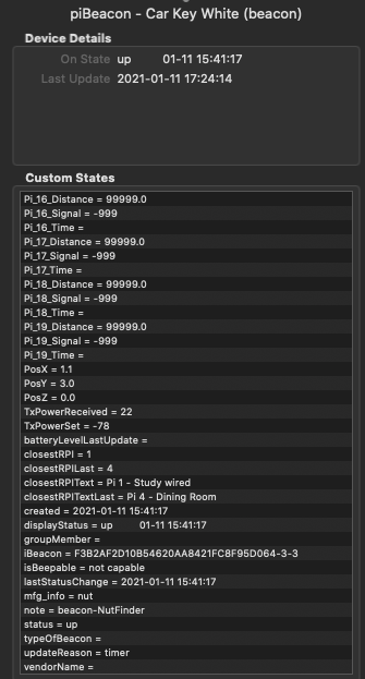

siclark
Posts: 2356
Location: UK
Re: piBeacon: 7- tested Beacons
Post by siclark »
Hi Karl
I have just received a pack of 4 Nut 3s but whilst I have them connected now they both show Not Capable for beeping and dont respond if I set them up. I did pair one to the app, but have since unbound it and closed the app. Another I havent even had the app running since I set it up.
Any ideas on how to get them to beep?
Do they show up as beacons?
Then go into device edit and set iBeacon type to nut3
siclark
Posts: 2356
Location: UK
Post by siclark »
Yes they show up as beacons, I see the ibeacon id (confirmed one matches that in the Nut app before I unbound it and killed the app).
Strangely the typeOfBeacon custom state is blank despite my having set it. My Nonda iHere (ZUS) does show in this custom state.
The msg_info is nut and note is beacon - nutFinder, but vendorName is also blank.
Screenshot 2021-01-11 at 17.24.53.png (80.5 KiB) Viewed 5438 times
Screenshot 2021-01-11 at 17.24.37.png (47.17 KiB) Viewed 5438 times
