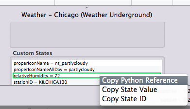

For custom plugin devices, you can see a list of all of the custom states directly below the device details window. Select the plugin device, and then right-click on the custom state and select the information you want. There's not a "Copy AppleScript Reference" option, but you should be able to infer pretty easily from the information that's there.
I'd strongly encourage you to use Python over AppleScript--especially if you are still learning--It's not that much harder to pick up, and it's a much better option IMO.

In fact, you have to use Python. Custom devices (and their states) aren't available in AppleScript.
