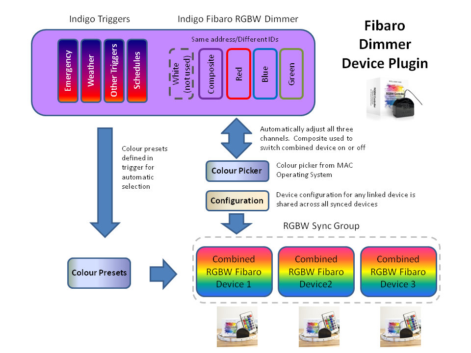

What does it do?
The overall use case is shown in the following diagram:

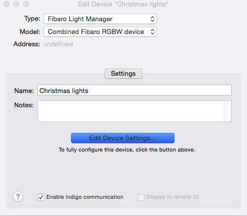

Ok I've installed it - what now?
You can now create a new type of device - Combined Fibaro RGBW Device
Fibaro RGBW Device Screen
Screen Shot 2015-06-28 at 17.17.53.png (43.36 KiB) Viewed 2699 times

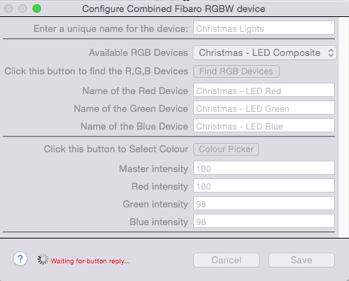

If you now click on Edit Device Settings you'll be presented with the following dialog
Screen Shot 2015-06-28 at 17.25.57.png (66.45 KiB) Viewed 2699 times
Click on the dropdown for Available RGB Devices and select the Fibaro Dimmer Module you're interested in. Then click Find RGB Devices and the plugin will automatically find and complete the boxes for Red, Green and Blue channels for you.
Now you need to select a colour. Click on Colour Picker and the Colour Picker tool will appear. Select the colour you want and then click OK to save. The plugin will then calculate and fill in the RGB values for you automatically.
You can also fill these values in yourself (0-100) if you prefer.
Once that's all done click Save and your device is ready for use.
