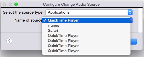

One of the problems I was having was getting an error dialog notice that QuickTime could not run because another version of Quicktime was already running. Not true. There is only one version of QuickTime on the computer, and neither the Dock nor Activity monitor showed it running prior to an execution of the scheduled item. I was using script to switch the Airfoil source to QuickTime and changed to use the Airfoil plugin for that action.
While trying to fix the schedule item that plays an announcement via QuickTime, I noticed something strange.
Strange... I might have fixed some things. Time will tell. I am still using 4.8.14 with plugin v1.1.9. (I haven't taken the time to switch back to v1.1.8 yet.) What version of the Airfoil plugin are you using?
- Change Source.jpg (30.54 KiB) Viewed 3864 times

We get that application list directly from Airfoil. Does it show multiple copies of the QuickTime Player like that in it's source popup?
I'm using v1.1.9 of the plugin.
Re: Airfoil update broke the plugin?
No. The Airfoil pop-up only shows one selection for QuickTime.
