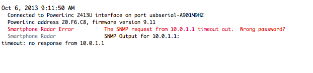

I am trying to set up Smartphone Radar using a new apple airport and I get the timeout wrong password? error.
I know that I have the correct IP and PW, so I need a little advice as trouble shoot this.
It worked well with my previous airport.
thank you in advance, John.

I'm having the same issue.
Airport Extreme 7.6.4
Airport Utility 6.3.2
Mavericks GM build
Mavericks GM build

If it is the new airport that supports AC wireless, those devices no longer support SNMP.
Some alternatives are Fing, FMID (Find my idevice) and a system to trigger off of Find my friends by triggering a script based on receiving an email. There are threads on all three in the forums.

I know that this is an oldish thread, but I've just spent a few hours trying to get this to work and my solution was different (and easy) to any I've read so I thought that I'd share it in case it helps anyone else.
I was getting exactly the same wrong password error, after confirming that I was using the older extreme (the rectangular one), so this should have worked. But no matter what password I tried it would not change. So then I managed to get an old version of Airport Utility running on my Mavericks mini and a bit of delving showed an SMTP menu I'd never seen before and it said that the SMTP password was public (must be a default)
So I changed the password in the SR setup to public and instantly it all worked beautifully.
Re: help with Smartphone Radar
This is important and should be made clear in the instructions. Apple Airport Utility does not have an SNMP password - set the password in Smartphone Radar to "public" for Airport Extreme N (Mac Mini shaped).
