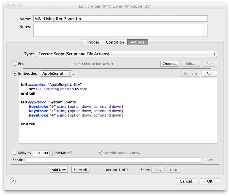

Took a little playing with the script to getting it to work. Now it does just what I wanted.
Below is the zoom up script for anyone who needs to do the same thing.
Zoom down just replace "+" with "-"
Thanks again Elwood
Thanks again Elwood
