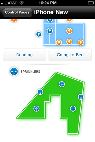

OK so my first foray into Python. I am sure there are lots of stupid errors here but I can't find many example Indigo python scripts around yet.
My sprinkler control page is attached.
What I want to do:
1) The larger sprinkler button in the top left represents the on state of the sprinklers. Orange for on, blue for off.
- Tapping in the off state begins the sprinkler schedule.
- Tapping in the on state stops all sprinklers.
2) I can run individual sprinklers by tapping their corresponding icon. Their colour changes. A second tap switches that sprinkler off again.
3) Provide a control page to adjust individual sprinkler durations.
It's more complex than I thought...
Here's what I have written out so far.

2) On the control page I have two image files named avon_sprinkler.png and avon_sprinkler+On.png. These are set to reflect device state of that particular zone. This works fine.

2) On the control page I have two image files named avon_sprinkler_large.png and avon_sprinkler_large+true.png. These are set to reflect the variable value of sprinklers_On. This works fine.
