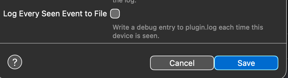

edit the indigo phone device that does not stay on:
at the bottom check the Log every.
save
the open a terminal session on the indigo Mac and paste:
click on select and paste the string into the terminal window
you should see some entries there like:
after the iPhone went down and up please copy the lines and post the lines from around that time here or email to karlwachs at me com
save
tail -f '/Library/Application Support/Perceptive Automation/Indigo 2025.2/Logs/com.karlwachs.networkscanner/plugin.log'you should see some entries there like:
2026-07-29 00:32:14 Net_5C:AD:BA:1B:DB:66 iphone1xprokarl detected: 5c:ad:ba:1b:db:66 IP=192.168.1.85 vendor=Apple via traffic observed (tcpdump)
