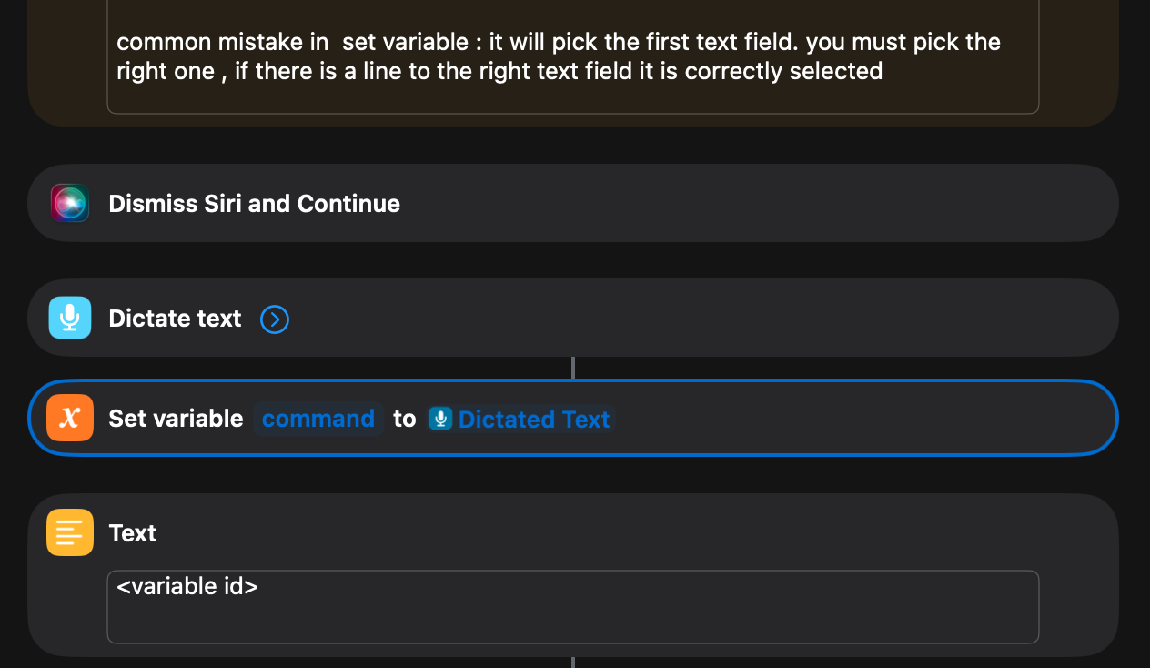

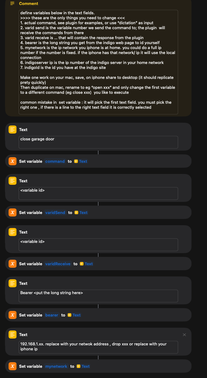

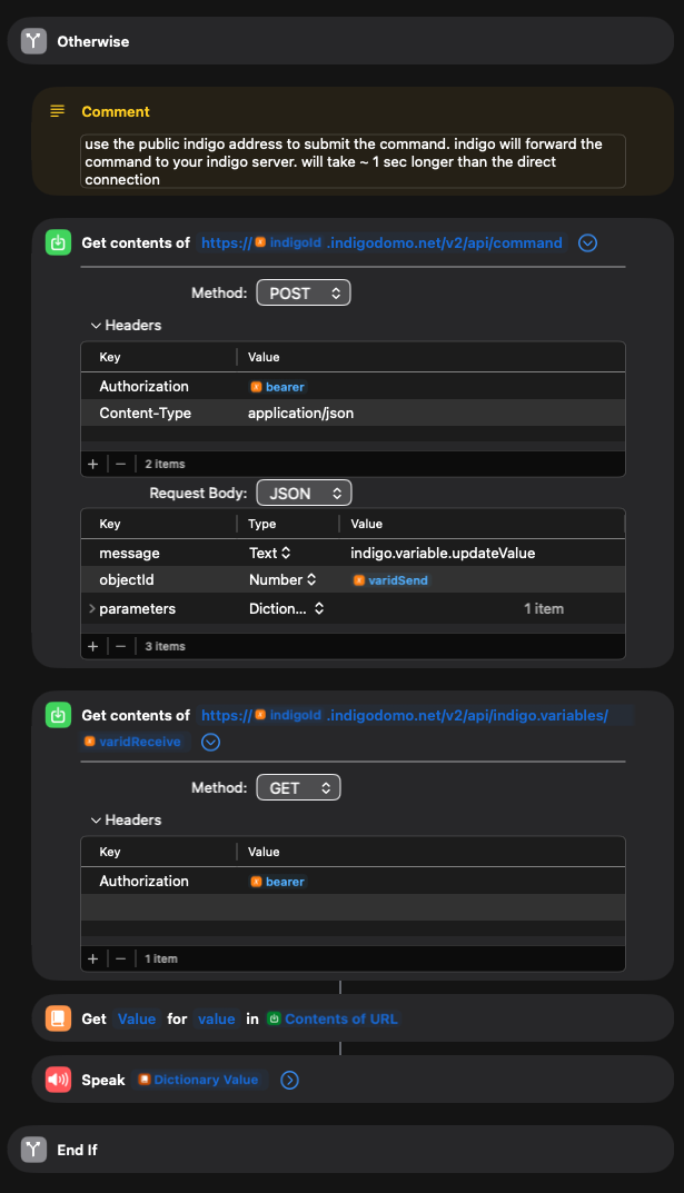

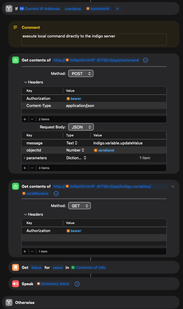

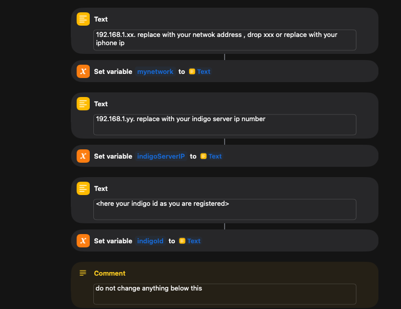

(B) === Create shortcut on iPhone with the following items: ====
you can download a shortcut with empty keys etc athttps://www.icloud.com/shortcuts/467123 ... 3589cf6579
then replace the <xxx> with your variable ids, ip numbers users bearer ... etc
speaking "hey Siri Indigo" pause "turn on office lights"
you could also define eg "hey indigo do" as hey siri replacement for this shortcut:
settings / Accessibility / vocal short cuts / add action / select yor shorcut say "hey indigo do" 3 times save
if you have a light named office lights:
"hey indigo do" pause "turn on office lights" should turn on your office lights

1. added "straight (plain) action command": when enabled in config ("enable straight action command"),
speak the exact name of an indigo action group to run it directly, no synonym needed.
tries to match the exact name first, then a normalized compare ignoring case, spaces and "/".
see also readme at GitHub https://github.com/kw123/VoiceReceiver
or indigo plugin downloads https://www.indigodomo.com/pluginstore/316/
an advantage of this method is that it will be using a direct connection to the indigo server when you are at home (in your wifi) and does not go through the internet to indigo host and then back to your home.
my experience this is > 1 sec faster.
updated the screen shots
