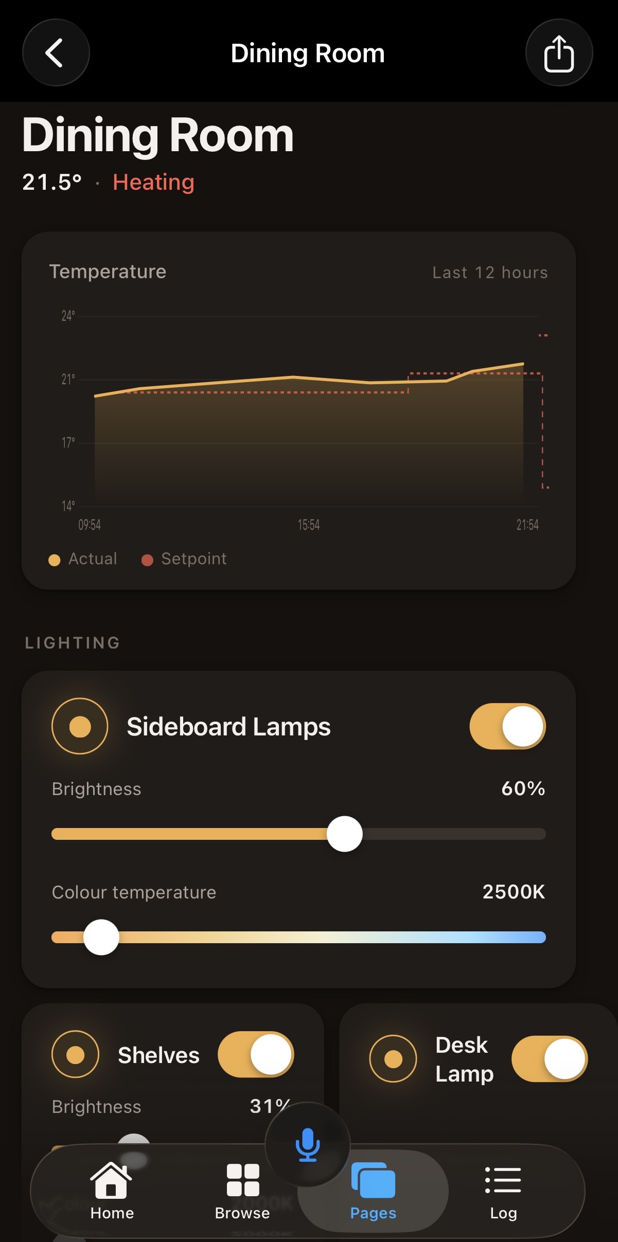

Sorry for the spam, but I have had some fun upgrading the skill and testing how far it could go.
I have also used the /frontend-design skill and got this detailed evaluation of how we should build a room page.
Design Context (from our work)
Target audience: You and your family — people viewing this on iPhone primarily, iPad occasionally, sometimes desktop browser. Private home use, not a commercial product.
Use cases:
Quick glance at dining room state from anywhere in the house
Adjust lighting mood when entertaining (dimmer + warm/cool temp)
Check if the heating's actually working (dining TRV + parent downstairs zone)
See temperature trend over the last few hours
Brand personality/tone: iOS-native feel, matches the existing Home Summary/Security pages we've built. Refined, understated, not maximalist. Think "the Apple Home app done well" — dark mode friendly, generous whitespace, meaningful use of colour, SF Pro typography.
Constraint: Self-contained HTML — everything inline, including the chart library (will use a minimal SVG-based chart, no external libraries).
Phase 2: DESIGN — Proposal
Here's the dining room layout concept:
│ Dining Room │
│ 19.5° · Heating │
│ ║ TEMPERATURE CHART (full width) ║ │
│ ║ Last 6 hours, sparkline style ║ │
│ ║ Current setpoint as dashed line ║ │
│ LIGHTING ───────────────────── │
│ │ 💡 Sideboard Lamps ON │ │
│ │ ━━━━━━━━━━━━━━━━░░░░░░ 60% │ │
│ │ Warm ━━━●━━━━━━━━━━━ Cool │ │
│ │💡 Shelves │ │💡 Desk Lamp │ │
│ │ dimmer + │ │ toggle │ │
│ │ slider │ │ │ │
│ HEATING ────────────────────── │
│ │ TRV (Primary) 19.5° │ │
│ │ Target [ − ] 21° [ + ] │ │
│ │ 🔥 Valve 100% · 🔋 64% │ │
│ │ Zone: Downstairs 20.8° │ │
│ │ Target 28° · Program heating │ │
│ │ (view only — controlled by │ │
│ │ master Heatmiser schedule) │ │
Design decisions:
Header: Big room name, small status line showing current temp + heating status
Temperature chart first: Most glanceable info, full-width SVG sparkline showing last 6 hours with target line overlay
Section headers: Small uppercase subtle labels (LIGHTING, HEATING), left-aligned
Primary light card (Sideboard Lamps): Full width, shows on/off toggle, brightness slider, AND colour temp slider (warm → cool gradient background)
Secondary lights (Shelves dimmer + Desk Lamp relay): Side-by-side smaller cards
Dining TRV: Full width, current temp prominent, setpoint controls with − / + buttons, valve position and battery as subtle metadata
Downstairs zone: Full width, clearly marked as view-only parent zone, shows current temp + target, explains it's controlled by the master schedule
Chart API: Uses existing /message/com.simons-plugins.domio/history/?device_id=X endpoint from the plugin
Colour palette:
Background: warm dark oklch(0.18 0.01 40) (slight amber tint, not pure grey)
Card surface: oklch(0.22 0.01 40)
Text: oklch(0.95 0.005 40)
Accent (warm, dining-room appropriate): amber oklch(0.75 0.15 65) instead of the usual cool blue
Heat: red-orange oklch(0.65 0.2 30) when heating, grey when idle
On state: subtle glow, not neon
Typography: System SF Pro (already -apple-system), varied weights — 700 for room name, 600 for card titles, 500 for body, 400 for metadata. Tabular numerals for temperatures.
Room template approach: I'll structure the JS so device IDs and labels are in a single ROOM_CONFIG object at the top. To adapt for another room, just change that config. The rest of the page logic is generic.
You could of course really get creative and specific on the design rules for your pages.
From which it built, which I think is pretty cool.. certainly easier than using the many Home Assistant dashboard tools and looks just as good.
