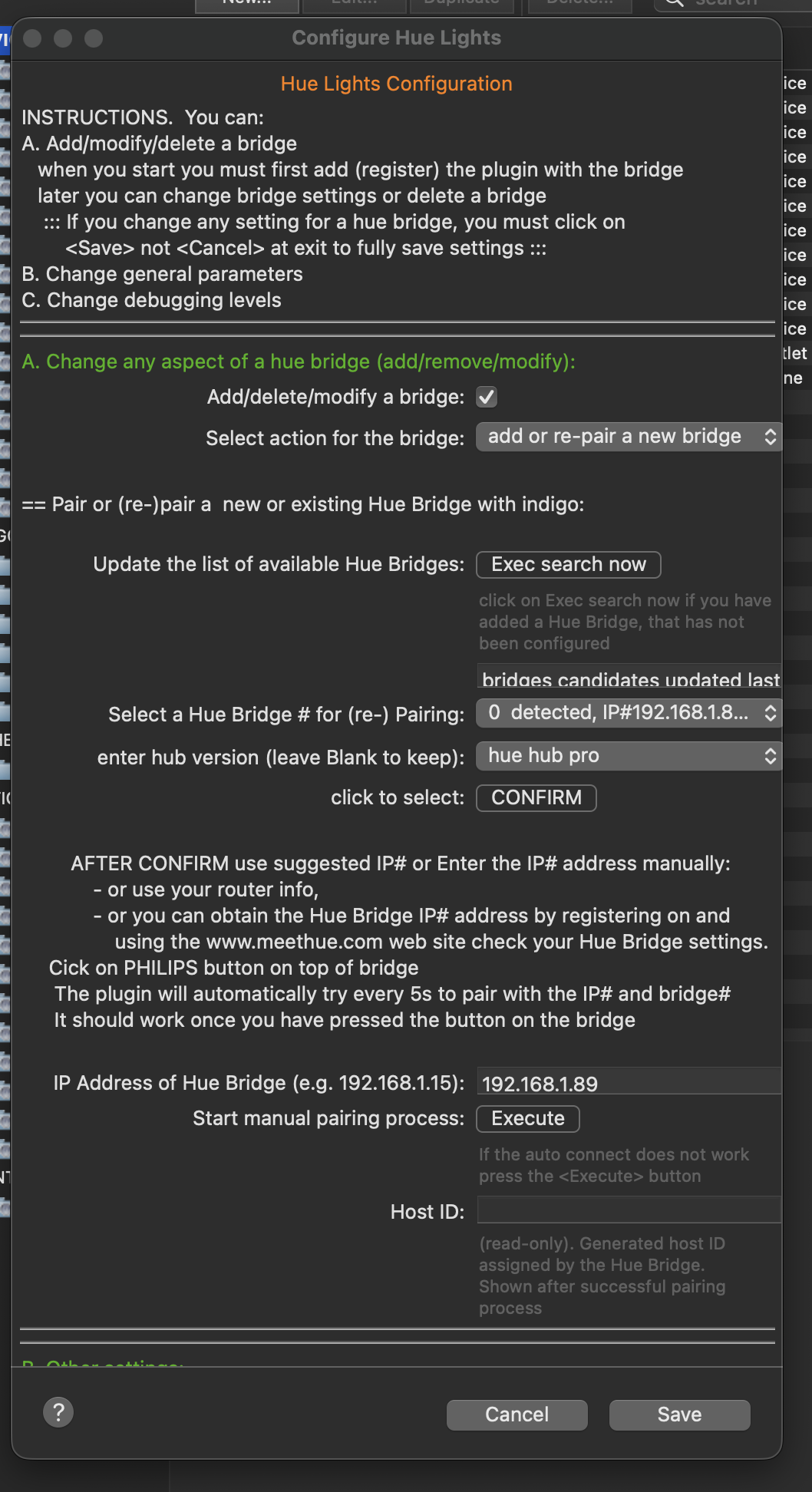

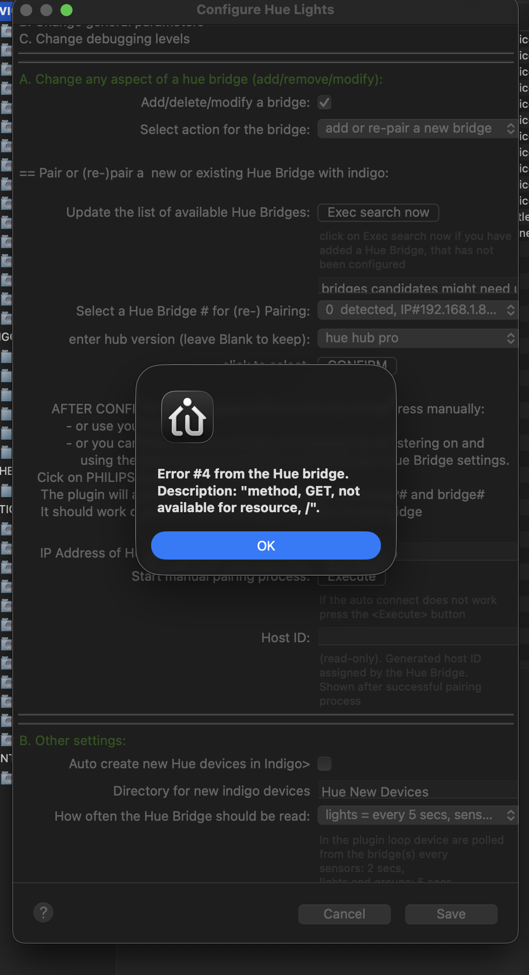

Sorry to report I cannot get the new Beta Hue Bridge Pro Plug to work in Indigo. Following beta instruction and pressing the bridge button does nothing. Plugin identiies the bridge and thats all it does for me at this point. Hope the screen shots helps. Im excited that you are working on this and thank you for your effort for our Indigo community.

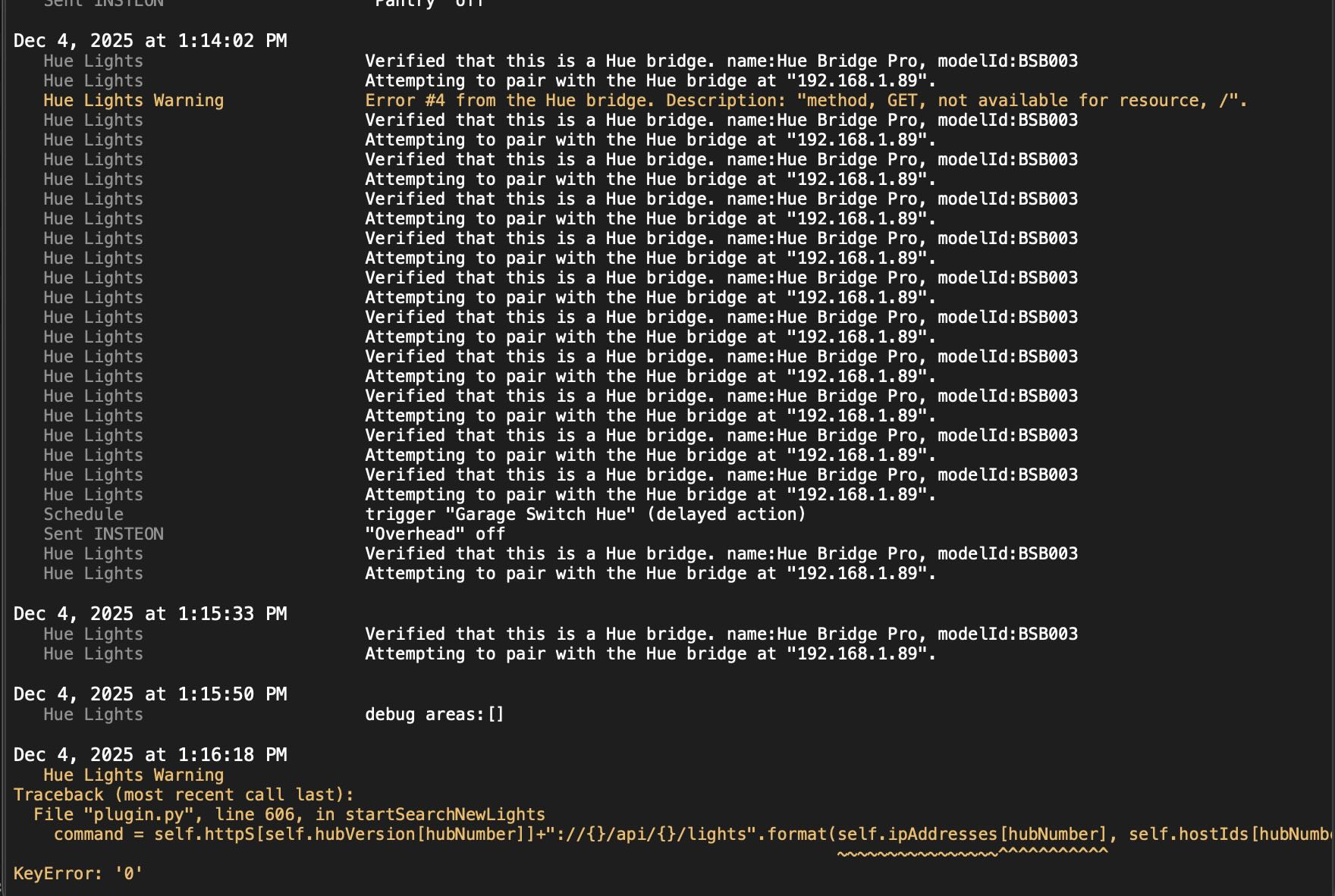

Thanks Im available today and next week but I believe our time zones arent in sync? At your convenience, let me know. Ive tried everything within my abilities to get the plugin to pair with my Hue Bridge Pro. Here is the log for your perusal. Thank you
