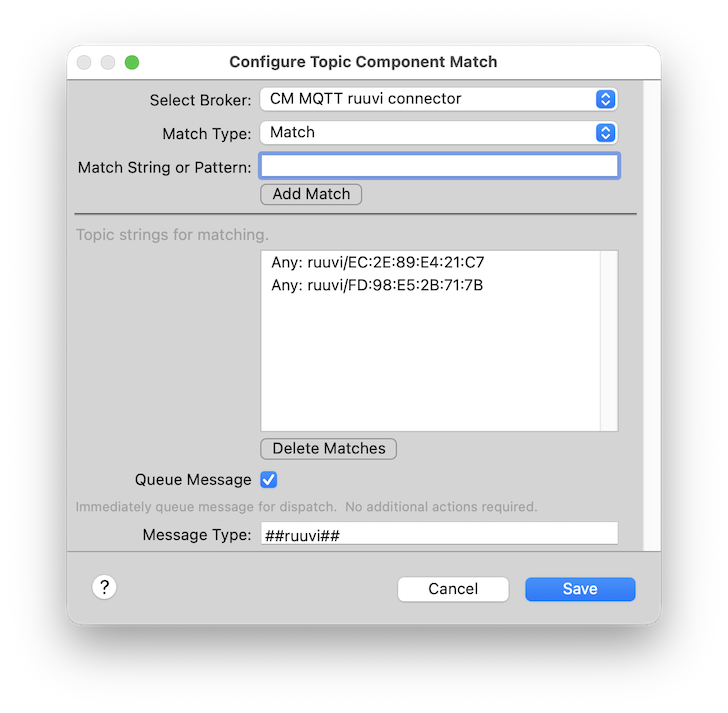

  1. I have a trigger to set the message type for a shim
    Screenshot 2025-12-05 at 11.54.44.png (154.77 KiB) Viewed 133 times
    This works fine. However, periodically it becomes un-enabled. I have no idea why, and nothing is logged. FWIW, this only seems to happen if I shift focus from the folder containing the trigger.

berkinet wrote: Fri Dec 05, 2025 5:04 am This works fine. However, periodically it becomes un-enabled. I have no idea why, and nothing is logged. FWIW, this only seems to happen if I shift focus from the folder containing the trigger.
Un-enabled where? You mean in the main Indigo Device list window? The comm-enabled checkbox? Or somewhere else?

FlyingDiver wrote: Fri Dec 05, 2025 7:53 am Un-enabled where? You mean in the main Indigo Device list window? The comm-enabled checkbox? Or somewhere else?
Sorry if I wasn’t clear. This is the trigger that sets the keyword for the shim to look for. So, it is the “trigger enabled” checkbox in the Trigger list

At some point the device was flooding the MQTT server with constant message. So, I created a repeating scheduled action to run every 10 minutes and enable the trigger for 4 seconds to capture an update, and then disable the trigger for 5 minutes. Then, the vendor added an option to set how often updates should be sent. So, I set it for 10 minutes. But, I had forgotten about my "fix." This effectively blocked any updates.
