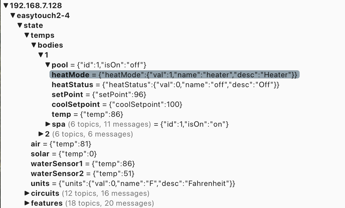

I have a few MQTT things working for my pool but am now trying to get notifications of when the heater is running. (See MQTT Explorer Pic below)
The Heater status is both in the heatMode and heatStatus topics, but I'm interested in the heatMode topic at the moment. When the heater is running, the "val":1, field is "1", and the "name":"heater" field is "heater". When off, those two fields are "val":0 and "name":"off"

2. From the MQTT Explorer, I have copied and pasted, and added this topic in the subscription field to the connector:
0:easytouch2-4/state/temps/bodies/1/pool/heatMode
2A. as a side note, I am also subscribing to other topics with this connector and don't know if the ORDER of the subscriptions matter, but my subscription list is not top to bottom as shown in the MQTT Explorer.
3. I've created a new Shim device, the Broker is the one I have set up for other pool devices, and the Message Type is the same as the other Shim devices for the pool.
4. The Unique ID Location is set as a "Topic Component"
5. Based on the MQTT Explorer, I'm counting from zero and my Topic Field seems like it shout be "6".
6. My Unique ID Value is "heatMode"
7. State Value Location = Payload Fields, Payload Type = JSON, and Payload Key = "name" (including quotes)
8, For the On Value field, I have "heater" (including quotes) (hoping to capture either of the two options being "heater", or "off")
9. Sensor Type is Generic, as Power On/Off or "Motion Sensor" don't seem to apply.

I've been able to get some other Shim Devices working for the pool, but the data for those isn't buried in a data string like the data I'm interested in here, so I'm guessing that's where my problem is with this.... I'm not correclty defining the data field that I'm trying to access. I'm also halfway assuming that I don't have the Payload Key set up right, and think I may need to include that whole data string, Also thinking the double brackets matter here as well, but I am nevertheless lost on this one.
And the Shim device in Indigo is grayed out, just more indications that I don't have this set up right.

2. Remove pool from your subscription. Pool and heatMode are peer topics, not subsidiary.
3. Message type needs to be unique for each different value you’re extracting from the topic.
4. Correct. And it’s the easytouch2-4.
5. Your unique id is in field 0
6. You can use name, but the val field is more correct. However, those nested curly braces are important. That’s a json dict containing another dict, so the correct payload key is “heatMode.val”. That’s both keys required to identify the field, connected with a period.
It’s sometimes easier to put he connector in debug mode and see the messages in the log, rather than another app. That way you can be sure that your subscription is working, and see the actual topics, as the app merges them into its UI.

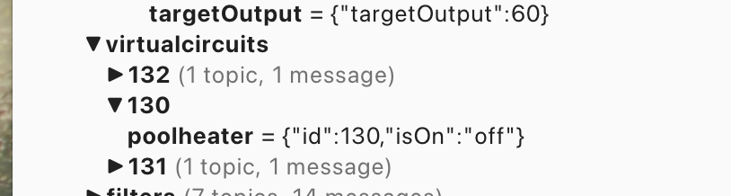

1. I've disabled as much of my meager MQTT setup as possible to focus on this one project. I've put the Shims plugin into Debug mode(a great tip, thanks), and while I did change the subscription as you suggested, I still see both the heatMode and heatStatus are subscribed, as well as virtual circuit 130/poolheater which also indicates if the heater is on or off as well. (see pic below) I'm also guessing this is because the first subscription in my Connector is "easytouch2-4/#" which I think by default automatically subscribes to all topics. Guessing I can delete that subscription, but it's working so am hesitant to mess with it at the moment. From the debug log, you can see heatMode, heatStatus, and poolheater are all reporting in.

Virtual Circuit info:
