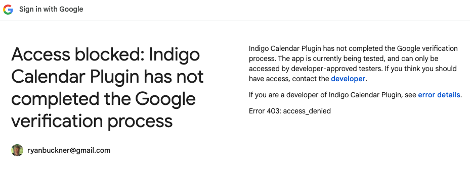

I get this 403 error when trying to Authorize from the plugin menu. Can you help with troubleshooting?

I was able to figure this out. This required going into the API settings and adding my email address as a test user under "Audience"
