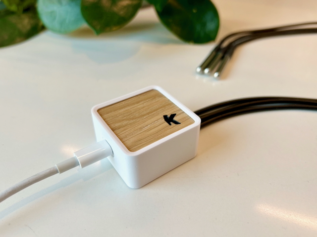

Sure! Here is one of my more refined creations. It measures three different temperatures using waterproof DS18B20 probes. Custom PCB with JST connectors, allowing for easy connection of sensors.

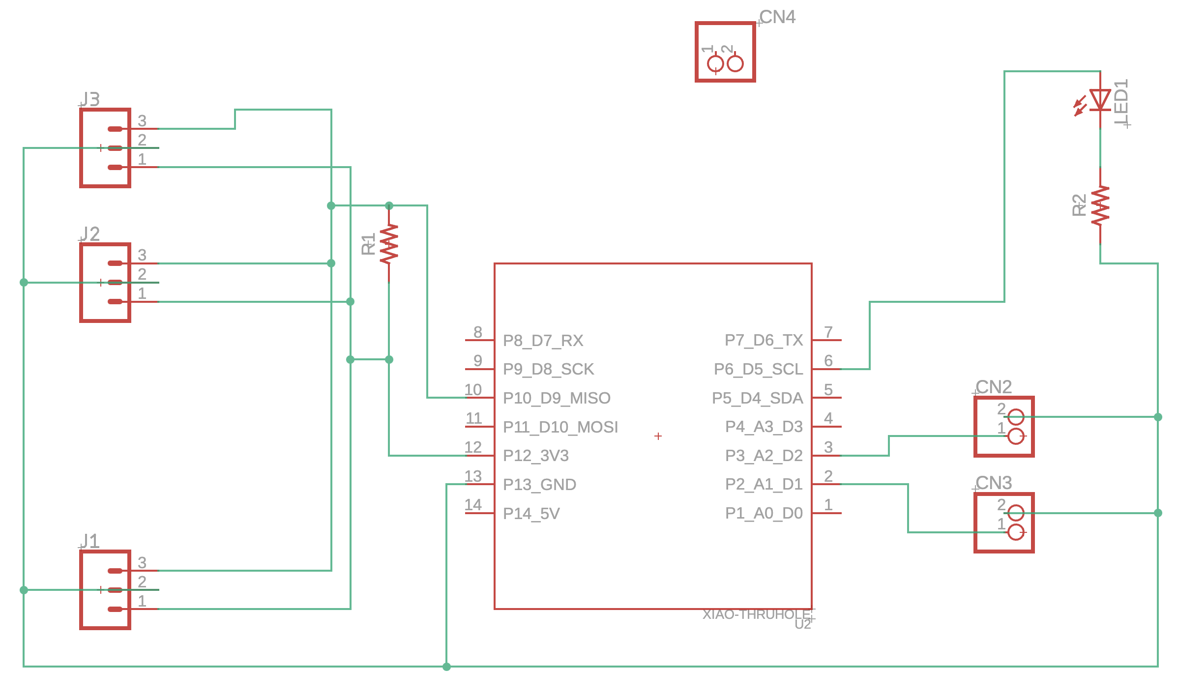

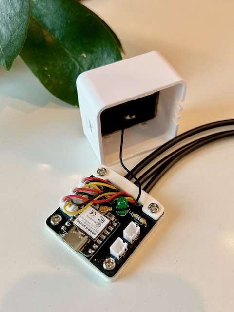

Pretty simple PCD with connectors for three bus sensors, two binary sensors, a LED for testing and an optional battery connector.

oh my God man that is sick! very professional! I assume ESPhome allows for deep sleep mode? You could probably fit a little light bow in there and run it for years!
