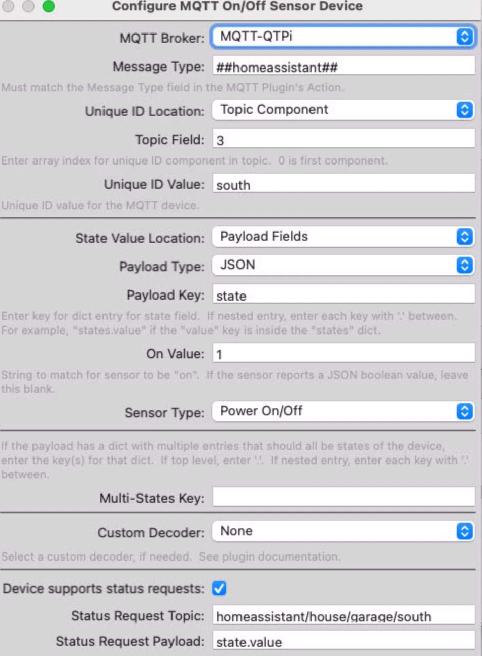

Hi there,
Getting my feet wet with MQTT - thanks so much for your plugins here.
Getting this error when I try to get the status of an MQTT shim device:
`MQTT Shims Error MQTT-House South Garage: actionControlDevice: no action template`
I'm not sure what an action template is or where I set it...
Here is my setup for it (attached).
Any suggestion what I'm doing wrong?
Joe
Screenshot 2024-05-18 at 8.16.59 AM.jpg (222.54 KiB) Viewed 945 times
Re: MQTT Shims Error - No action template
Yeah, OK. In general, sensors don't do actions, so there's no template for that. The fact that it allows for a status request is a bug.
More importantly, don't use MQTT for communicating with Home Assistant. Use the Home Assistant Agent plugin instead. It's much better. It also doesn't require the MQTT integration in Home Assistant.
