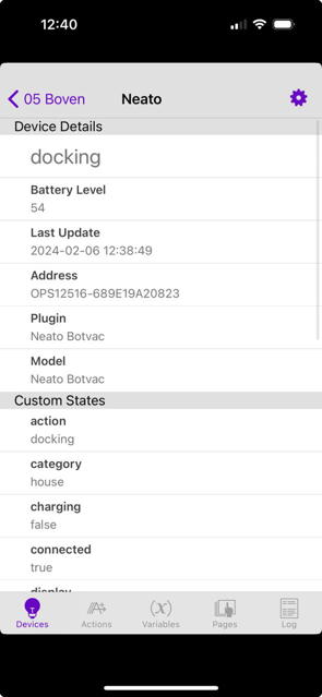

Thanks for both responses.
The positive thing is that there is feedback from the Neato robot to the Plugin.
Like battery status, docking and a message when she (it's not a he) has finished vacuuming:
2024-02-06 14:05:03.142 Neato Botvac "Neato" request status
2024-02-06 14:05:03.665 Neato Botvac Debug "Neato" available commands: {'start': True, 'stop': False, 'pause': False, 'resume': False, 'goToBase': False}
2024-02-06 14:05:03.669 Neato Botvac Debug "Neato" status update complete
2024-02-06 14:05:03.669 Trigger Neato is finished (with a message)
So she only talks one way and doesn't want to listen to commands.
