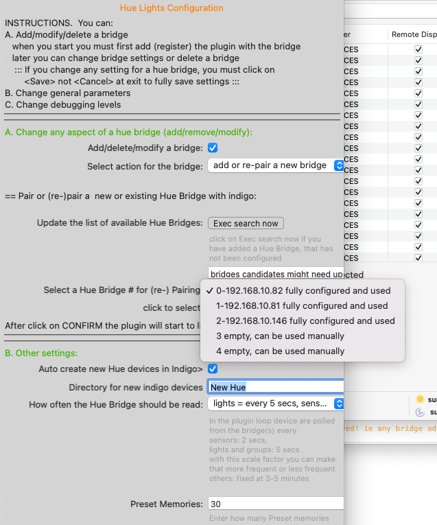

I have 3 hubs configured. Want to add another hub. It is working with the Hue app on my iOS device and the lights on this hub are all manageable through the Hue app.
I cannot seem to be able to add it to the Hue Plugin. I am assuming the issue is the interface between the keyboard and the chair.....
Have tried to follow the instructions with pressing the Hue Bridge button, but no progress!

Select #3. Then enter ip number manually. That should always work
Ps you can have at most 4 bridges. Zigbee uses 4 bands of the 2.4 ghz wifi Channels.
There is a chance of wifi zigbee interference.
