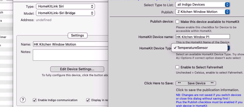

Glenn, I am trying to add some Aqara motion sensors to HKLS but unlike other Z-Wave and Zigbee motion sensors the Aqara sensors only show Temperature as an option, no motion.
Screenshot 2023-11-04 at 10.51.59.png (276.65 KiB) Viewed 1033 times
Any suggestions?

If you click ShowAllOptions
You can make the Motion Sensor pretty much anything in homekit. From a Lock to a OccupancySensor to a Motion sensor to a door….
Not to say they all will work… Image… but if have click showallOptions, select motion sensor and use the True/False state that reflects motion. Then yes it should work.
If you want one device to be a temperature sensor and a motion sensor - you will need to duplicate it somewhere.
The very latest version has some motion sensor updates - which may or may not impact the issue you are seeing. Doesn’t seem the same issue from what you are saying here. Click download code button and use the latest github version - will release very soon.

GlennNZ wrote:If you click ShowAllOptions
That's what I was getting wrong, I always ticked the box but after I chose the type so did not realise it showed all the options!

Good all sorted - as I said a True/False state device can be any number of True/False type homekit sensor devices.
The risk with showallOptions is if you publish an incompatible device, which will relate to the state used - this homekit bridge will become unresponsive without much messaging, often none. If this happens just unpublish device, wait for its disappearance, and try again.
