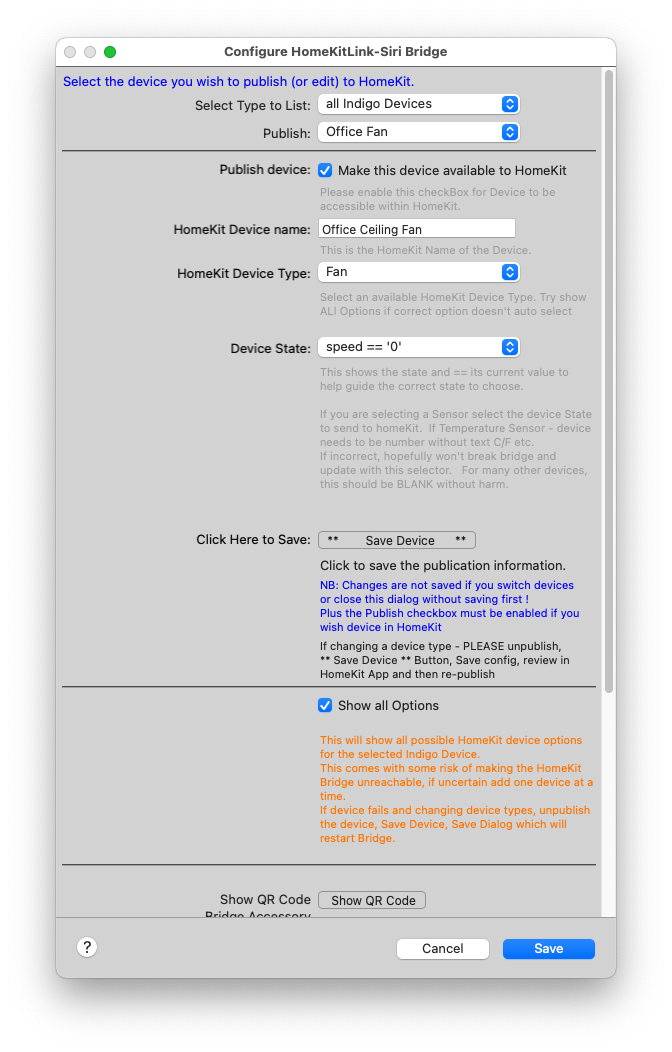

Okay, I have the light working, but I can't control the fan itself. This is the error I get:
HomeKitLink Siri Error (plugin.py: Function: Plugin_setter_callback line: 2471): Exception : Message : Error in setter callback
HomeKitLink Siri Error Traceback:
File "plugin.py", line 2408, in Plugin_setter_callback
indigo.device.turnOn(accessoryself.indigodeviceid)
HomeKitLink Siri Error Error in plugin execution:
TypeError: device "Office Fan" class type Device is not compatible with action turnOn/turnOff/toggle/setBrightness/lock/unlock/open/close
Exc_info: (<class 'TypeError'>, TypeError('device "Office Fan" class type Device is not compatible with action turnOn/turnOff/toggle/setBrightness/lock/unlock/open/close'), <traceback object at 0x1220d0a40>)
Exc_Text: Traceback (most recent call last):
Stack_info: None
Exc_info: (<class 'TypeError'>, TypeError('device "Office Fan" class type Device is not compatible with action turnOn/turnOff/toggle/setBrightness/lock/unlock/open/close'), <traceback object at 0x122105680>)
Stack_info: None
- Screenshot 2023-10-04 at 10.07.24 AM.png (221.81 KiB) Viewed 1630 times
How to use with ceiling fan with light?
Hi
The error message seems to describe it well - surprisingly for an exception message - Office fan doesn’t respond to any of the usual Indigo commands as it is not an Indigo device. It (presumably) is a plugin custom device for the SenseMe plugin. As we discussed without it being an Indigo device support will vary depending on how the plugin behaves. It this case it seems even a Homekit switch (On/off) device will fail as it appears it doesn’t support those commands.
This comes back to the core issue at hand here which is you are trying to add Plugin custom device (not standard Indigo devices) to homekit, having used a Plugin to get them into Indigo in the first instance.
This Custom/External Device —> Indigo Plugin —> into Indigo and then use HKLS to publish this device out of Indigo into Homekit. And then Homekit then reverses this process. This is convoluted and not ideal or a focus of HKLS.
Add a masquerade device (if possible - but the same problem exists for masquerade plugin) or a Virtual Device with action groups giving on/off. Add as switch device and within the Home app can change it to a Fan icon/type I believe.
Alternatively would be to add a HomeKit Senseme plugin to your other homekit/HomeBridge install via a plugin (a quick google suggests that might not exist though, which probably highlights how fringe this case is.)
Supporting plugin custom devices fully was never on the cards, nor would it be possible, and the impact of all this back and forth problematic to say the least. Particularly in the current scenario where Apples HomeKit just stops responding without error messaging if unhappy about anything within the bridge.
