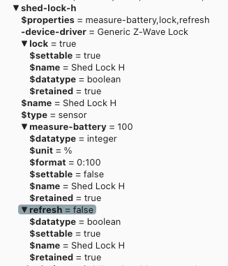

You could do an initial test via MQTT Explorer by publishing a command to lock and unlock it with a topic of homie/<your_hub_name>/shed-lock-h/lock/set with a raw payload of true (lock) or false (unlock).
Assuming the above works, to lock and unlock it, then I can add a lock capability to the plugin.

Success! First time--
The command you suggested is exactly correct-- with the raw "true," it locks. with the raw "false," it unlocks.

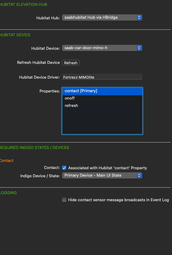

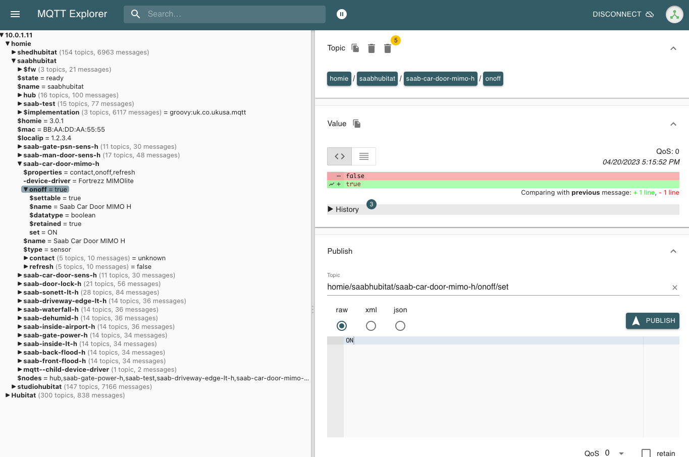

As I moved more devices from the Vera to the Hubitat, I ran across another odd device. My FortrezZ MIMOlite shows up as a Hubitat Bridge Sensor device, instead of an ON/OFF switch. I see the on/off as a property, but it should be a settable state. Although the MIMOLite has many uses, I use it as a momentary on/off switch to simulate a button press to open/close a garage door or gate. Using your previous coaching, I was able to make it open and close the door through MQTT Explorer and I'm attaching screen shots of the successful "button push" command. I needed to send an OFF command before sending another ON command to close the garage door.
Like the lock, is this a fairly straightforward add/alteration in the Hubitat Plugin? Thanks for any guidance you might have. And thank you for spending your time helping me with my project.

New pre-release published to Github: Enhancements, bug fixes and Lock device support
You should hopefully be able to select a Lock device type when creating a new device for your shed lock.
Let me know how you get on and if t is OK, I will push it to the Indigo Plugin Store.
I will look at your MIMOLite device in due course.
You might be able to add it as an Outlet device (which is based on a relay)?

You're right-- I changed the MIMO's Plugin settings to add it as an outlet so ON/OFF is the primary property. Also, in the Hubitat (main settings, not the MQTT app) I adjusted the MIMO's device configuration. I set the preferences to: Relay 1 control Manual. Relay 1 Auto Off set to 1 Second. The MIMO handles the button press automatically (per the hardware jumper configuration), so the Auto Off setting just prevents the need to send an Off command to reset the Hubitat state.
Thank you for the lock addition. And thank you also for the push to explore additional settings in both the Hubitat Bridge Plugin and the Hubitat's Device Preferences.
