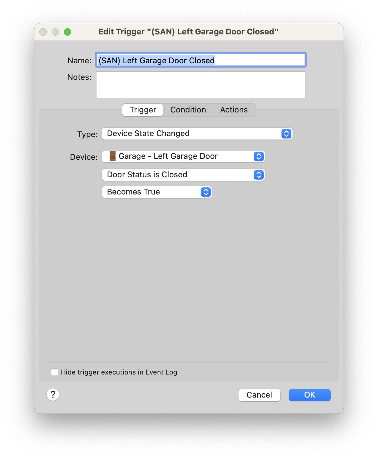

I have the MyQ Indigo plug-in and I can click the "Lock" and "Unlock" buttons on the device control panel to open and close. I also have a trigger that sends me a push notification when the garage door opens/closes. That works fine as long as I use the aforementioned buttons.
But if I walk up to the wall control and hit the button to close or open the garage door, I do not get a push notification. Here's an example when closing:
Screenshot 2023-03-21 at 2.24.49 PM.png (432.09 KiB) Viewed 1532 times
Is this the right way to setup the trigger?

For any changes not initiated by the plugin, you’re relying on polling the cloud server. Check the plugin prefs for the interval.
I would recommend a zwave tilt sensor on the door.

Thanks Joe. That makes sense.
I'm looking at using this solution along with a magnetic sensor and an ESP32 to roll my own garage door status/control. That will likely come later.
