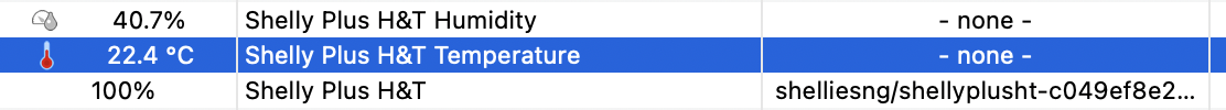

It's a new install - directly v 0.4 of the plugin; I received my H&T Plus yesterday.
The error is regular (when the sensor is sending the update). By default in the configuration, it's Fahrenheit, but It looks like the H&T is sending Celcius and Fahrenheit simultaneously.
I've saved "celcius" and now it's working - Temperature and Humidity shown correctly.

It used to be an error with Humidity as well. The trick is to force to save the config for each subdevice (temperature and humidity) - then the issue was fixed.
Error device "Shelly Plus H&T Humidity" state key sensorValue not defined (ignoring update request)

Yeah that is what I was trying to confirm. Those settings should be saved automatically when you initially create the device, but apparently they aren't. You confirmed that by simply saving the config and having it work. I'll have to check that out.shapa wrote:It used to be an error with Humidity as well. The trick is to force to save the config for each subdevice (temperature and humidity) - then the issue was fixed.
