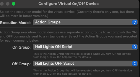

I have two Nanoleaf Essentials bulbs in HomeKit. Inside of Indigo, I have those two bulbs in a virtual group "Hall Lights" set up as an action group execution model. On sends one script command to Shortcuts, off sends another.
I also have that Virtual group exposed to HomeKit in HKLS. And this seems to be the problem.

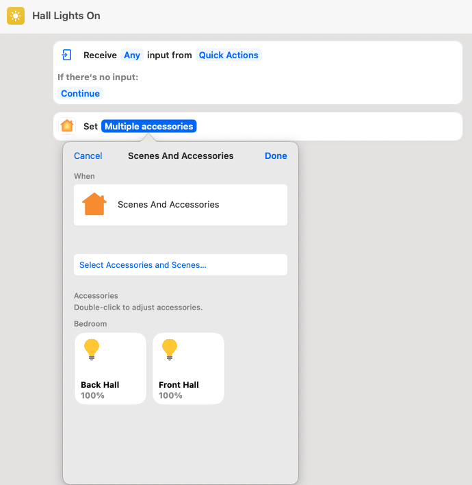

In Shortcuts, if I have the shortcut address each bulb individually, everything works as it should when triggered by Indigo or run in Shortcuts directly.
If I have the shortcut turn on or off the Hall Lights Virtual Device, I get

The only difference between "loops forever" and "executes correctly is in Shortcuts. Configuring the shortcut to turn off the two lights works. Configuring shortcuts to turn off the Hall Fixtures, which is an Indigo Virtual Device, loops. The big diff is that the two lights are "native" in HomeKit, and the Virtual Device is imported from Indigo.

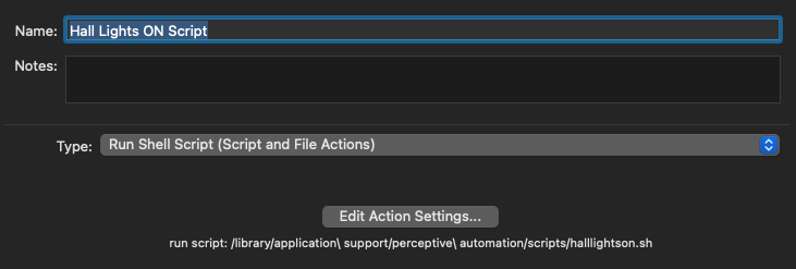

What the contents of the shellscript?

The entire ON script:
#!/bin/sh
shortcuts run Hall\ Lights\ On

I checked the dependencies on everything thoroughly, and the shortcuts themselves have only "turn this on" or "turn this off" in them. I don't do ANY automation in Home or via Shortcuts--it's all controlled by Indigo.
Shortcuts is only a bridge to the Home app, since you can use shell scripts to target shortcuts but not to target Home.
