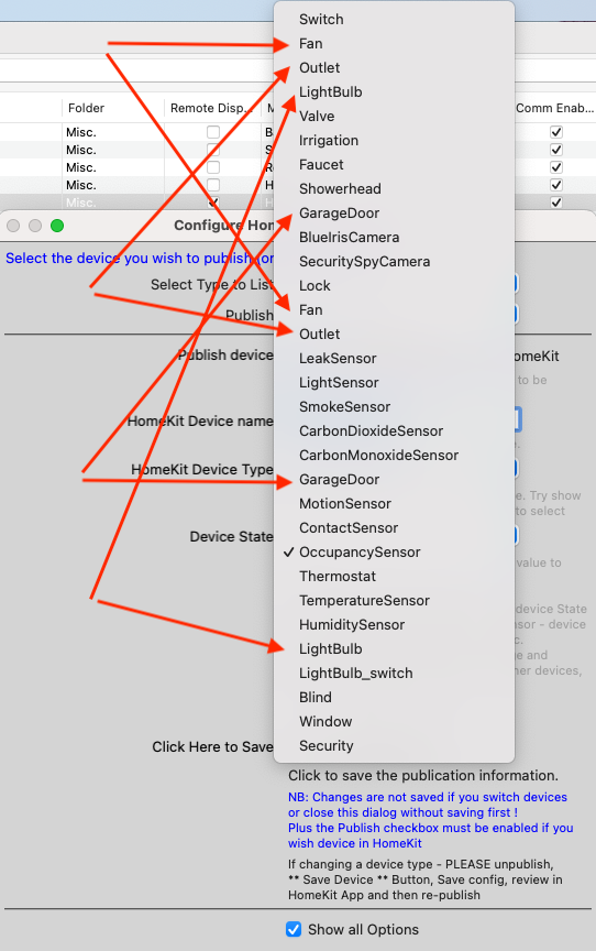

I am talking about these duplicate selections. Wondering whether there are any differences.
- Screen Shot 2022-08-06 at 6.31.52 PM.png (201.92 KiB) Viewed 1121 times
Re: OutletLinc icons in Home app
No - they are all the same. Will be a display issue as to how I grouped them for automatic selection. Similar devices grouped together.,Monstergerm wrote:I am talking about these duplicate selections. Wondering whether there are any differences.
Purely cosmetic.
Removed in version 0.3.18
