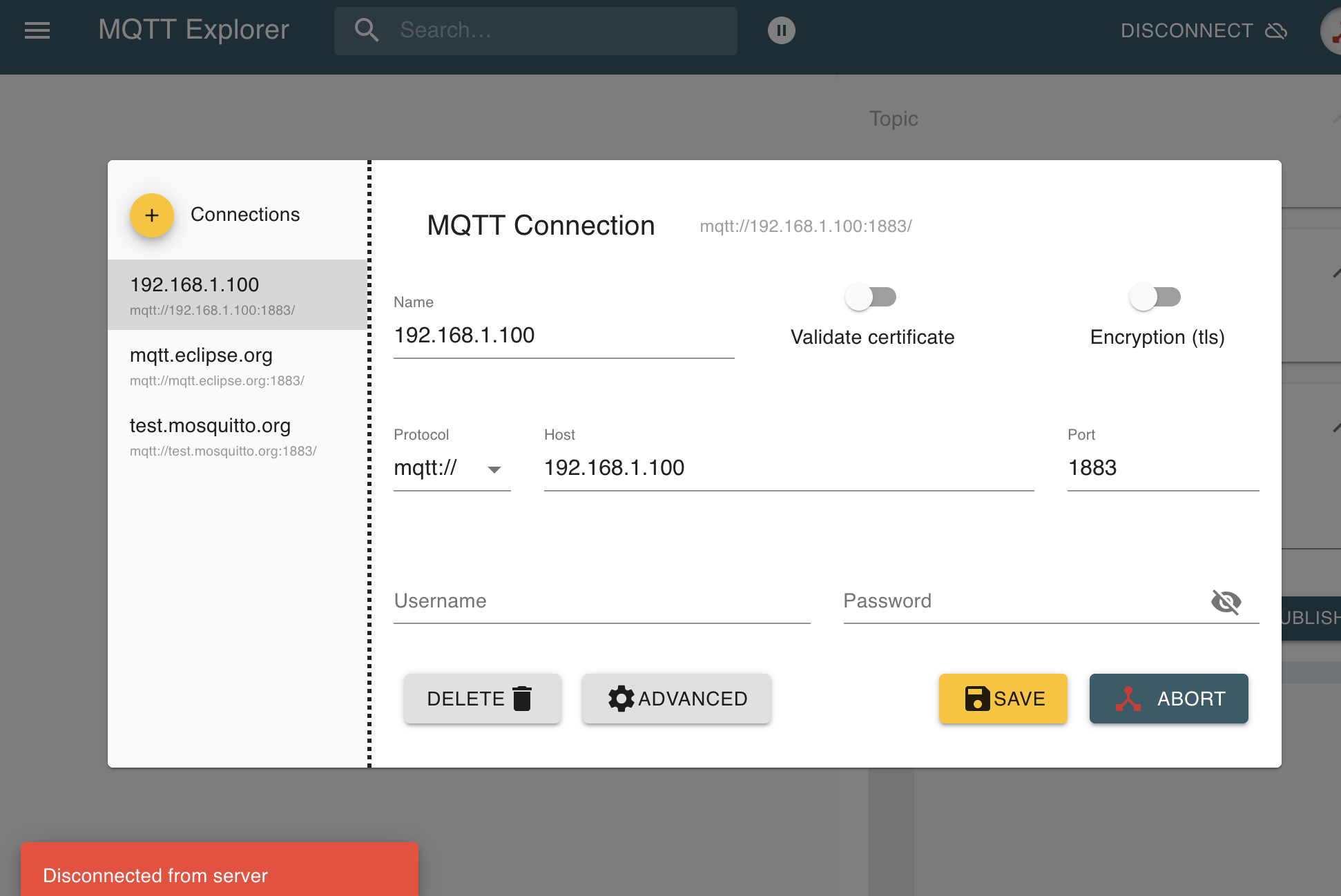

Thanks. Unfortunately the link did not fully go through - and I cant figure out the "..." in this case.

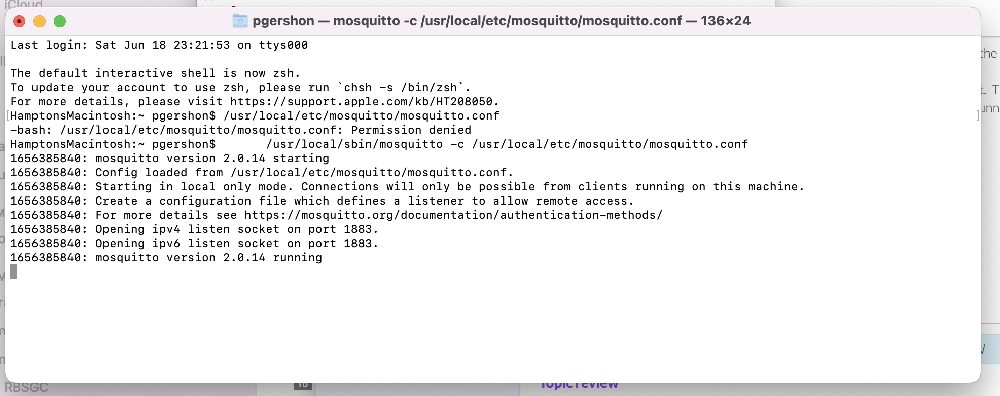

I have the MQTT Explorer loaded too. Unfortunately I am not able to connect. There is something, probably obvious, that I am missing. I am trying to connect to my host at 192.168.1.100. I am told disconnected from server. Posting screen shot. Either the server is not running or I am connecting the wrong way, or both. To get the server running, I am using mosquito with terminal window open (screenshot attached too)

Re: Having trouble getting started
Add the following 2 lines to the bottom of mosquitto.conf
listener 1883
allow_anonymous trueCliveS
Thanks. That got me past the roadblock. Will try to get plugin working tonight.

Mosquitto made this change between versions 1.x and 2.x, but these configuration parameters revert this change back to what is needed. (allowing connections to the broker from other devices)CliveS wrote:Add the following 2 lines to the bottom of mosquitto.conf
listener 1883 allow_anonymous true

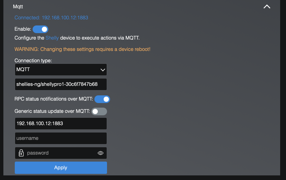

1. The first thing to do is configure your shelly device to connect to your broker. This is done by going into the Network settings of the device though the web interface. Here is an example of how one of my devices is configured.
Note that I modified my MQTT Prefix field to be "shellies-ng/shellypro1-30c6f7847b68". It was "shellypro1-30c6f7847b68" by default, but I prepended the "shellies-ng/" to ALL of my new shelly devices. This makes the trigger creation easier.

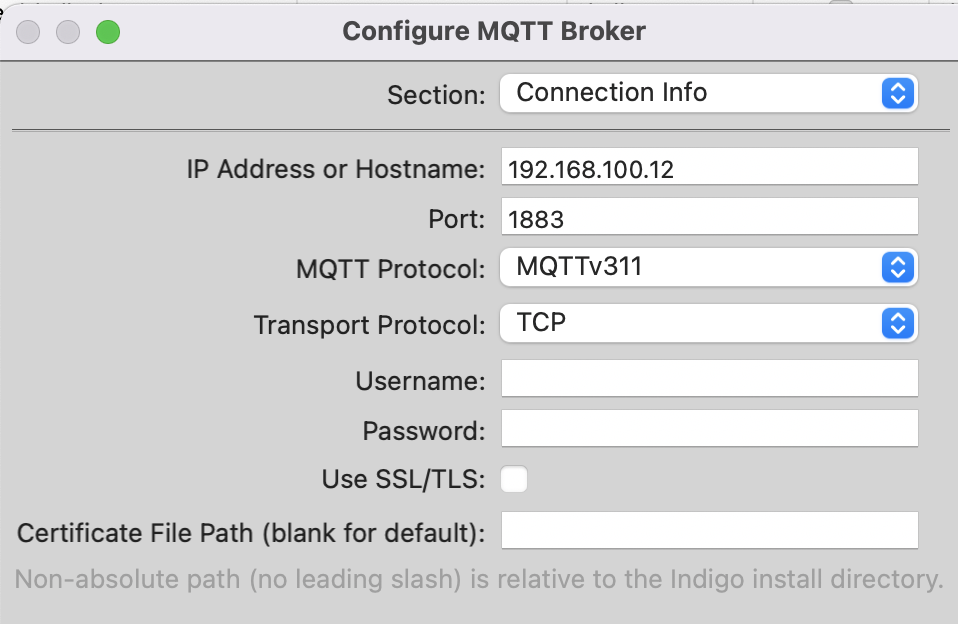

3. Now you need to connect Indigo to the broker. This is done using FlyingDiver's MQTT Connector plugin (https://www.indigodomo.com/pluginstore/211/). Create a new MQTT Broker device in Indigo and fill in your connection details. You should see the status bulb go green to indicate that communication has been established.

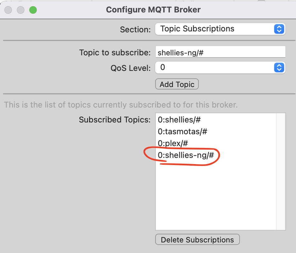

4. Now we will subscribe Indigo to the topics that your devices will communicate on. I prepended my MQTT prefix with "shellies-ng/", back in step 1, and this comes into play. This allows us to create a single MQTT subscription using wildcards. It will be "shellies-ng/#", and this will subscribe to any topic beginning with "shellies-ng". The # symbol is a multi-level wildcard, so it captures topics that are multiple levels deep, such as "shellies-ng/shellypro1-30c6f7847b68/relay/0".
In the broker device you should have created previously in Indigo, go to the "Topic Subscriptions" config section. Enter "shellies-ng/#" into the "Topic to subscribe" field with a QoS level of 0. Click "Add Topic", and you should see the topic subscribed in the list at the bottom.

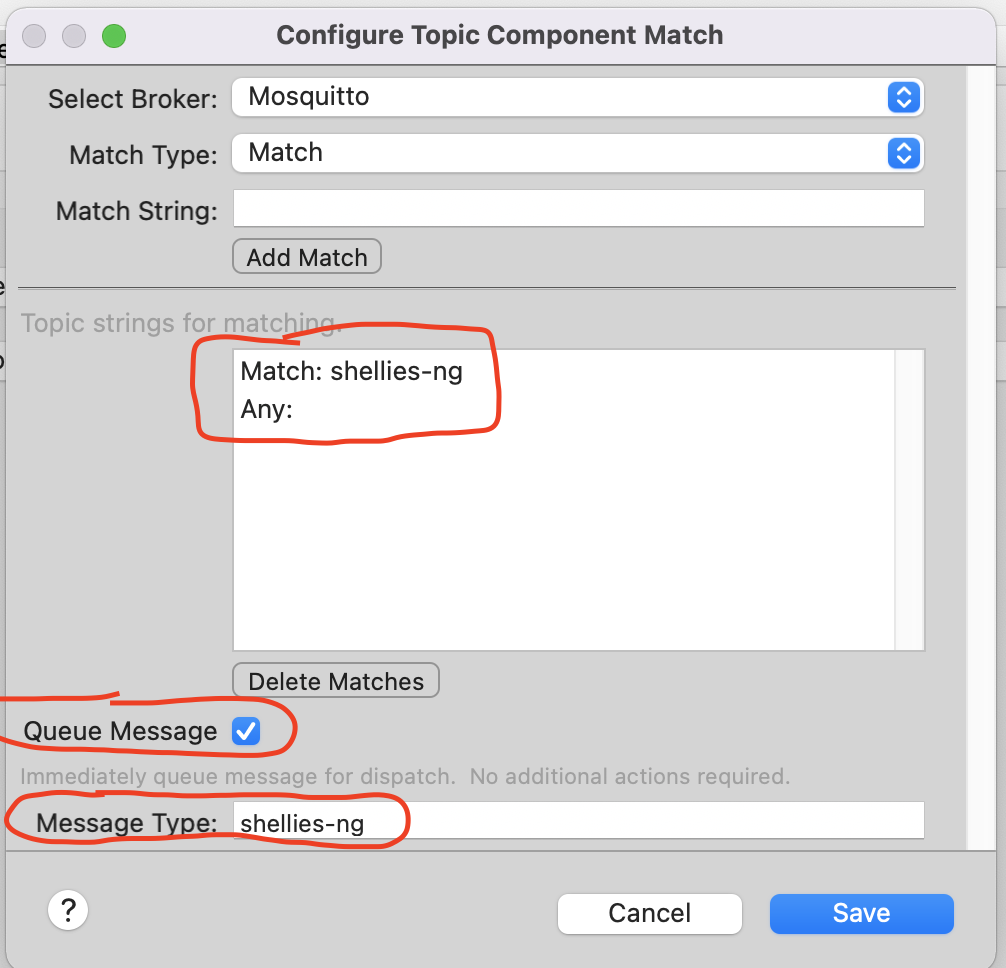

5. The next step is to create a trigger that will send the topic payloads to my plugin. Create a new trigger of type "MQTT Connector Event" with event "Topic Component Match". Select your broker device from the broker drop-down.
a. From the match type menu, choose "Match". Then type "shellies-ng" in the Match String text field below it. Click the Add Match button.
b. From the match type menu, choose "Any (wildcard)". Ensure the Match String field is empty. Click the Add Match button.
Check the "Queue message" check box near the bottom. Enter "shellies-ng" in the Message Type field at the bottom.
You do not need to specify anything else in the Condition or Actions tabs of the trigger. I do suggest checking "Hide trigger executions in Event log" as the shelly devices will be very chatty and will clutter the log.

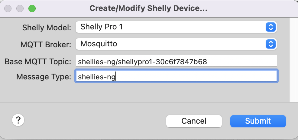

6. Create a new device with type "ShellyNGMQTT". A popup will appear where you can select the Shelly Model, MQTT Broker, Base MQTT Topic, and Message type. Select the model of the device you have and choose your broker from the broker menu. The Base MQTT topic is the MQTT prefix you entered in the device web interface. Message Type will be "shellies-ng" because all our MQTT traffic will come from the trigger we previously created.
