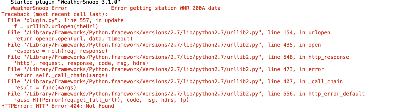

this is what I am getting in Indigo.
WeatherSnoop Error Error getting station WMR 200A data
File "plugin.py", line 557, in update
f = urllib2.urlopen(theUrl)
File "/Library/Frameworks/Python.framework/Versions/2.7/lib/python2.7/urllib2.py", line 154, in urlopen
return opener.open(url, data, timeout)
File "/Library/Frameworks/Python.framework/Versions/2.7/lib/python2.7/urllib2.py", line 435, in open
response = meth(req, response)
File "/Library/Frameworks/Python.framework/Versions/2.7/lib/python2.7/urllib2.py", line 548, in http_response
'http', request, response, code, msg, hdrs)
File "/Library/Frameworks/Python.framework/Versions/2.7/lib/python2.7/urllib2.py", line 473, in error
return self._call_chain(*args)
File "/Library/Frameworks/Python.framework/Versions/2.7/lib/python2.7/urllib2.py", line 407, in _call_chain
result = func(*args)
File "/Library/Frameworks/Python.framework/Versions/2.7/lib/python2.7/urllib2.py", line 556, in http_error_default
raise HTTPError(req.get_full_url(), code, msg, hdrs, fp)
HTTPError: HTTP Error 404: Not Found

As you noted, I removed WeatherSnoop 2 support from the 3.2.0 release of the WeatherSnoop Indigo plugin.
The error you're receiving is HTTP Error 404. This appears to be an error communicating with the WeatherSnoop 2 server.

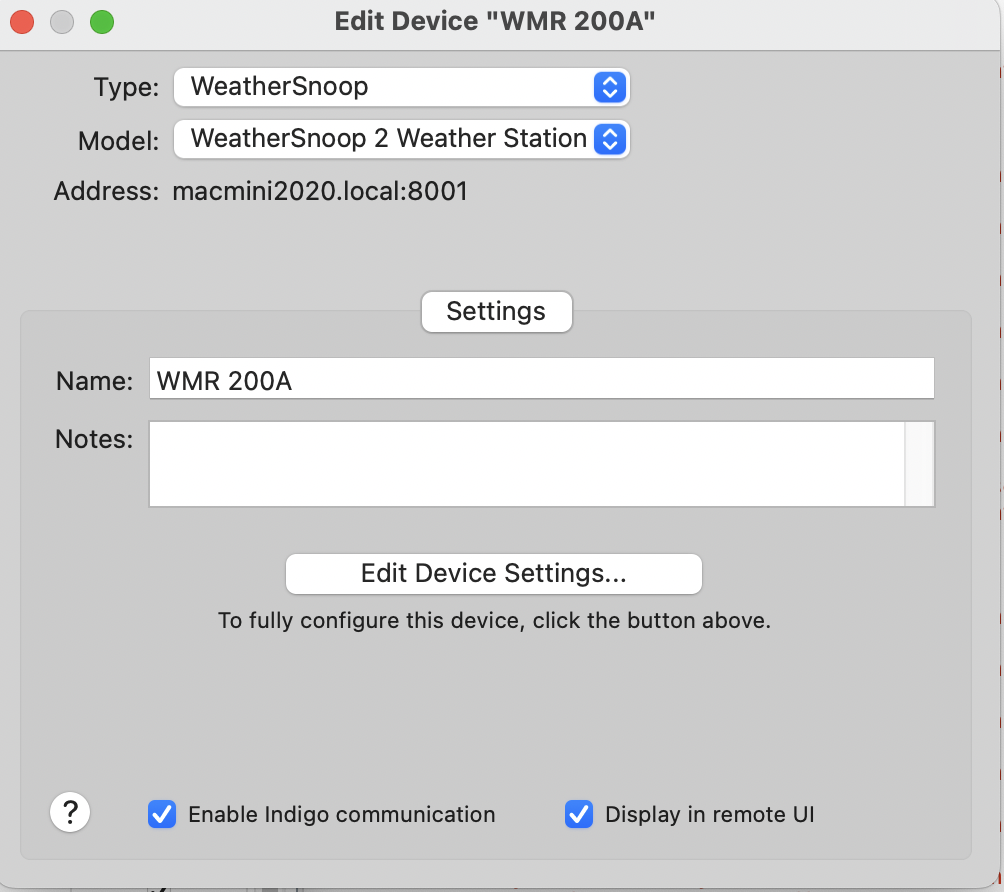

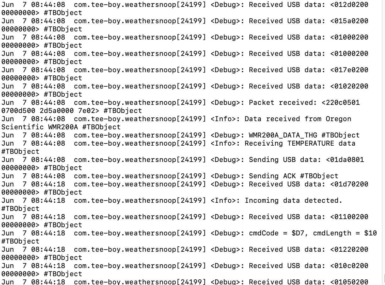

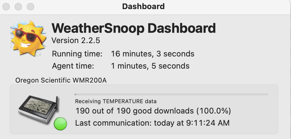

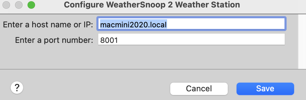

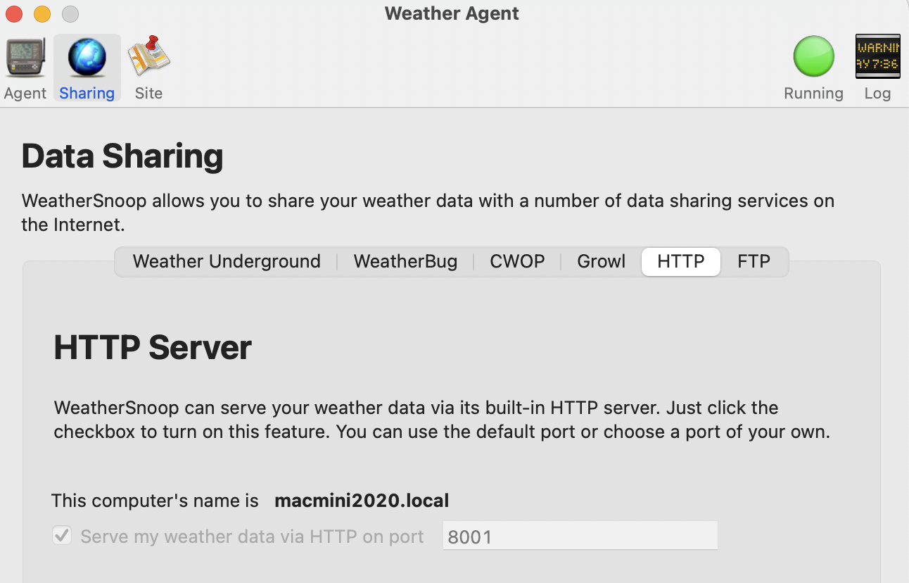

2 things changed......I had the weather station connected to a 11 year old imac. I was serving the weather via http on that iMac . The actual Indigo installation running the Automation is a Mac Mini. I was retrieving the data in Indigo by referencing the imac IP address and port and it was working OK......... The imac has been retired so I plugged the weather station directly in to the Mac mini and used its IP address and port in the Indigo setup and also upgraded the Indigo to 2022.1.1. Not sure which has caused the issue. FYI...I tried the IP address instead of "macmini2020.local". As you can see....Weathersnoop seems to be recieving the data from the weather station with no issues.
- Screen Shot 2022-06-03 at 9.11.28 AM.png (157.82 KiB) Viewed 6280 times

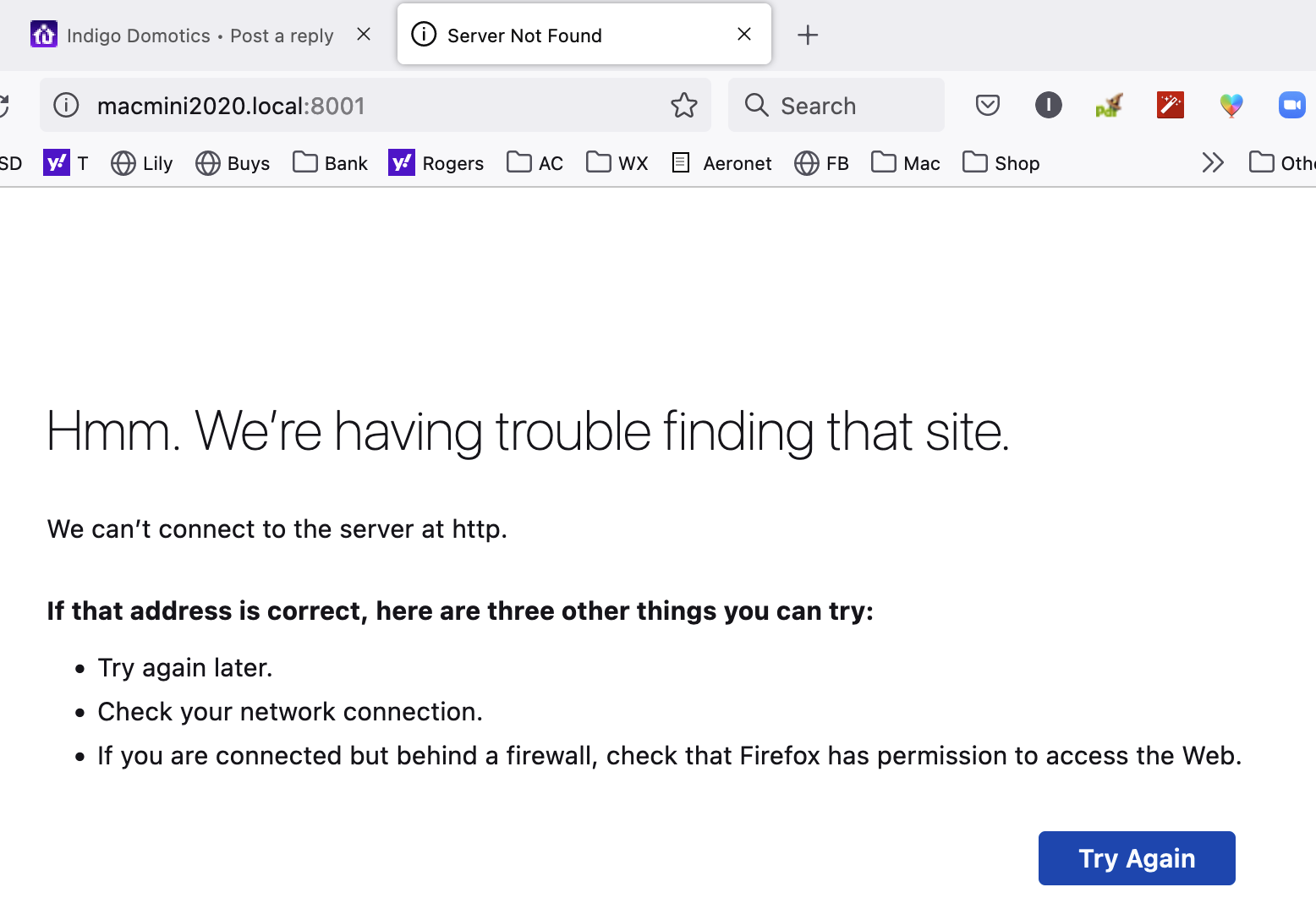

Everything seems to appear correct.
What do you see if you type this address in a browser on your Mac mini:
http://macmini2020.local:8001Re: Weathersnoop v3.1 instead of 3.2.
Does not appear to be getting anything...tried 2 diffrenet browsers just to make sure. FYI...Obviously a Macmini (M1) and running OS 12.4
- Screen Shot 2022-06-07 at 8.44.43 AM.png (293 KiB) Viewed 6237 times
That explains why the plugin isn't getting data from WeatherSnoop 2. For some reason, the web server isn't running.

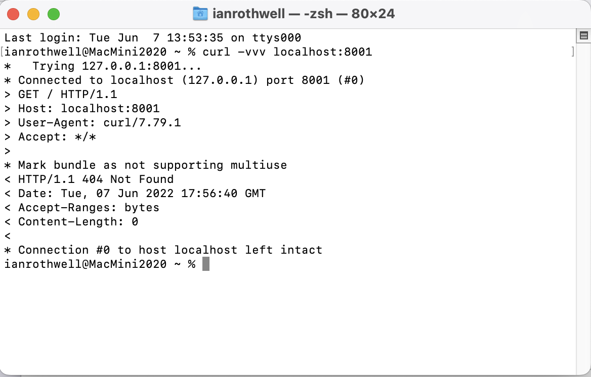

curl -vvv localhost:8001Re: Weathersnoop v3.1 instead of 3.2.
This what it returned
- Screen Shot 2022-06-07 at 1.56.48 PM.png (106.21 KiB) Viewed 6215 times

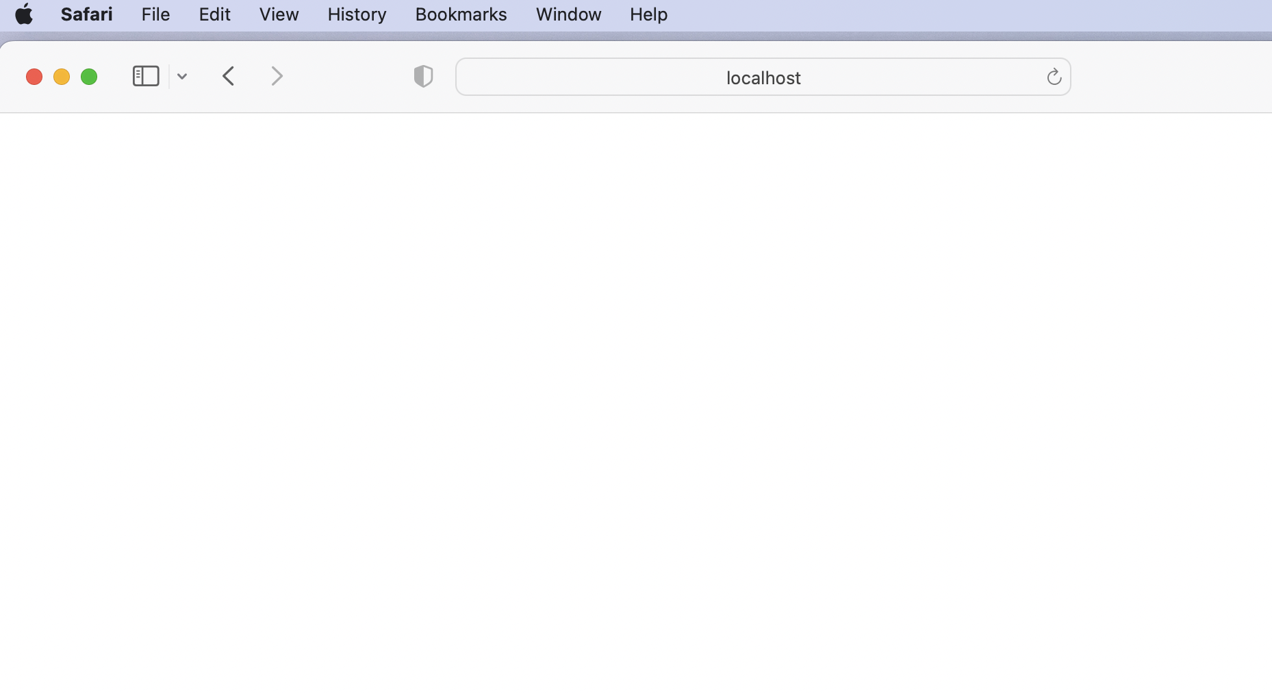

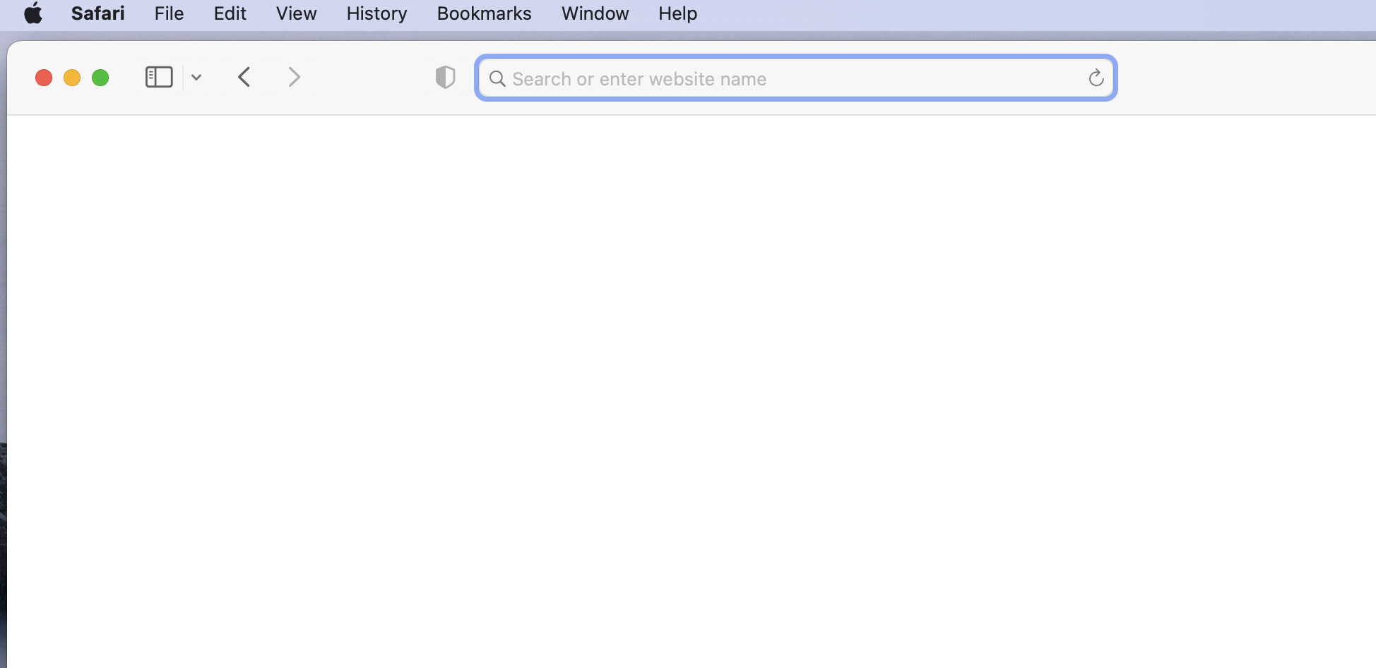

Alright, now type this in Safari:
What happens?

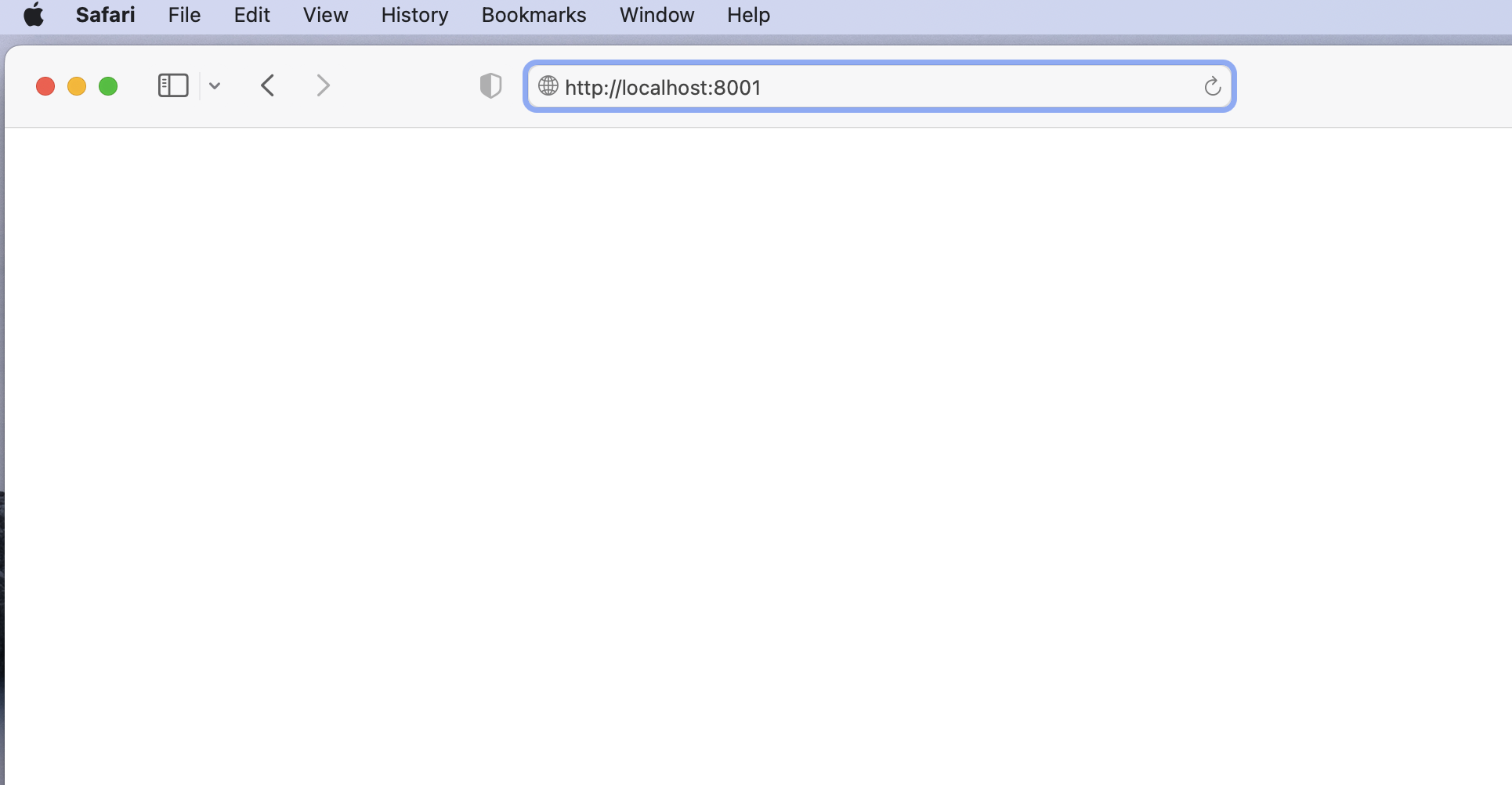

http://localhost:8001Re: Weathersnoop v3.1 instead of 3.2.
Nothing happens after I type it in....just a blank screen in Safari. Other websites do load so def connected.

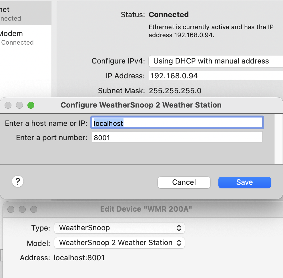

Ok, I think the WeatherSnoop 2 server is working, but only if you access it via localhost.
Can you setup your Indigo WS2 plugin to use localhost instead of the macmini2020.local and see if that makes a difference?

I tried with localhost and also the IP address but no change unfortunately after I reloaded the plugin.
- Screen Shot 2022-06-07 at 5.34.13 PM.png (289.07 KiB) Viewed 6183 times
