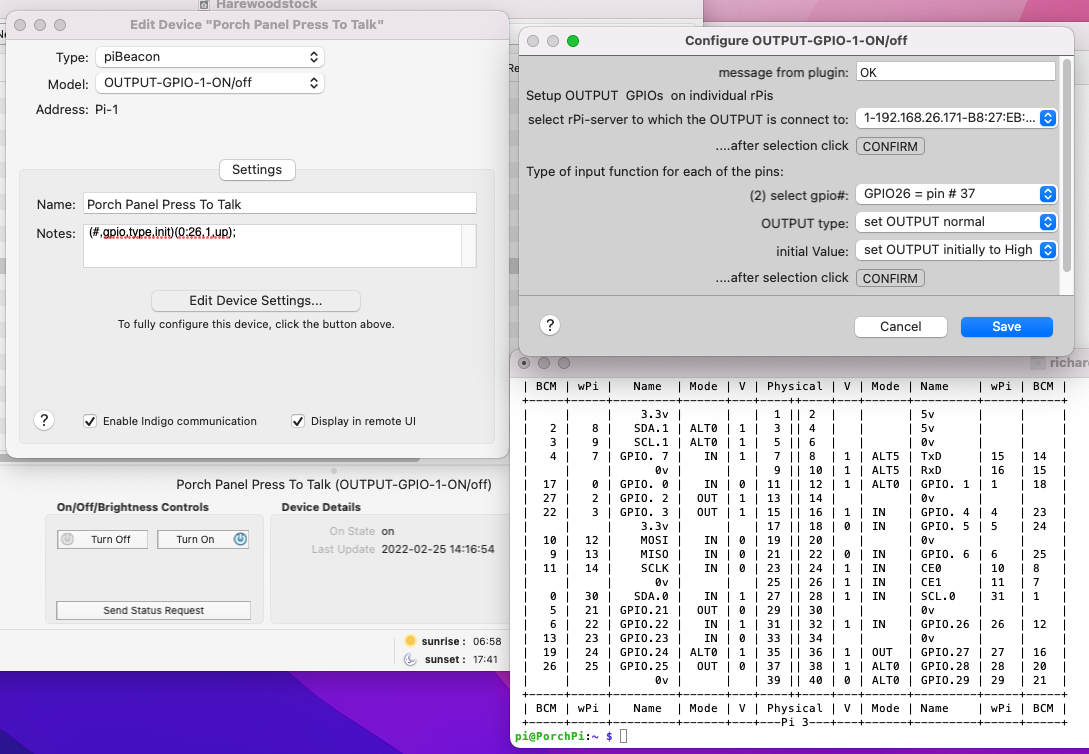

Re: OUTPUT-GPIO-1-ON/off only works when inverted
I tried mine and it works.
Could you post a screen shot of the device edit screen
Aww, you could at least put an 'e' on the end of invers
Please see screenshot - the device On/Off output is always 0 unless set to inverse, Here you can see the device is on yet physical pin 37 is shown as 0. It is also 0 when off.
Hi Karl,
I don't need to measure the pin voltage, I use a Python app to read its value.
The GPIO utility shown in the screenshot always stays on 0 unless the device is set to invers when I switch the device on and off. For now, to get around the problem before you fix it, I have modified my Python app to read this value the other way around and have set the device to invers. I could have just left it at that but I though I'd highlight the issue to you so that others do not run into the same problem using this piBeacon device type.
Note that this was working previously for about 2 years.
Put simply:
set OUTPUT invers = OK
set OUTPUT normal = FAIL (always 0)
Put simply:
