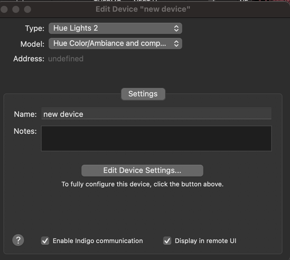

Bit of an update - would love some help on this please.
Indigo is seeing the 2nd Hue Bridge and reading it fine:
And the plugin appears to behave normally:

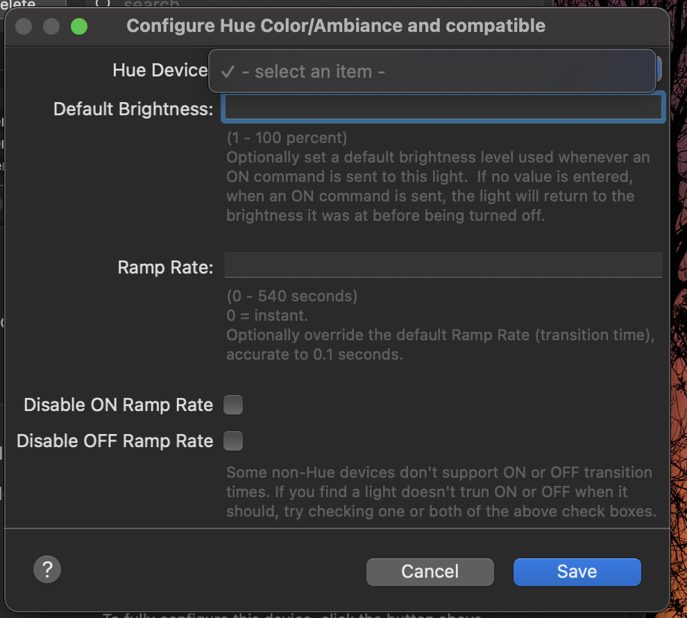

But no devices appear in the drop down, even though they have been read.
Any ideas please?
Andrew.

What kinds of lights are they? What does the information screen in the Hue app look like for the 2 lights that aren't appearing in the Hue Lights plugin? It's possible support for those lights hasn't yet been added to the Hue Lights plugin which would explain why they aren't appearing. Having the detailed information found in the Hue app will allow me to add support if that's the case.

The box says colour/ambience and they are the standard mushroom shaped bulb, pretty much the first bulbs Hue released. I have others just like them around the house.
In the Hue app info it says:
Light Type: Hue color lamp
Model: LCA004
Software: 1.93.7
It feels like something has changed since reaching the 63 bulb limit on the first bridge. How that would affect the second bridge I have no idea, its just a feeling!
Thanks for any support you can give, it's driving me nuts - lol.

Thanks for the details. That model is new (or at least never requested before). I'll add support for that model in the next Hue Lights plugin release. You can add support yourself though, by adding that model ID to the "kHueBulbDeviceIDs" list in the supportedDevices.py file within the Hue Lights plugin. (Right-click on the Hue Lights.indigoPlugin and choose Show Package Contents, then go into the Contents then Server Plugin folders where you'll see the supportedDevices.py file. It's just a text file that you can edit with any text editor). You'll have to make that change yourself anyway on the Hue Lights plugin copy that you've made for your 2nd Hue hub, as any updates I release and you install won't change that 2nd Hue Lights plugin.
