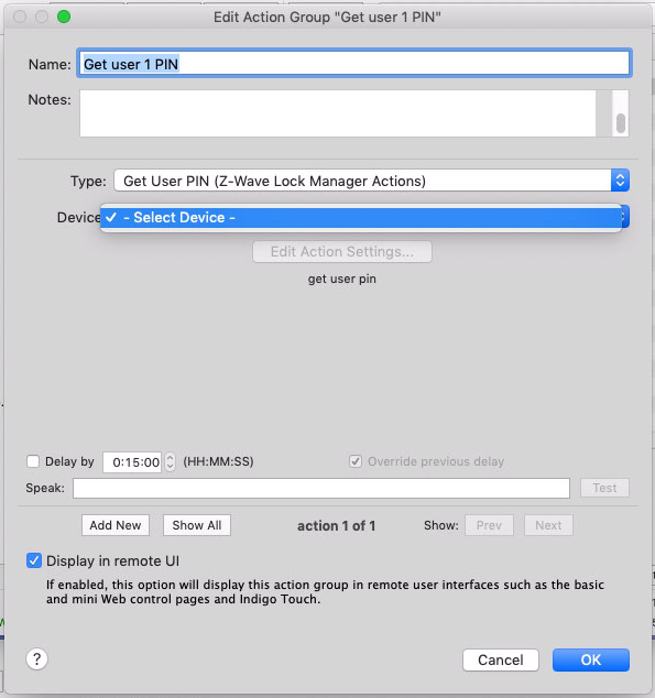

I just noticed that my Kwikset 910, which I've used with this plugin (v1.0.56) before, is no longer showing up in the device list:
Lock:
Thoughts?

Hi Jay
I can’t remember if those actions filter on my.plugin.dummy.lock devices, or on zwave.props.isLockDevice
Both those terms are off the top of my head and completely wrong but hopefully you’ll recognise what they’re supposed to be.
If it’s the former then I suspect you’ve deleted your ZWave Lock Manager > Dummy lock device.
(Unless your HDD is case sensitive in which case it’s the same as the previous topic in this sub forum)
Peter

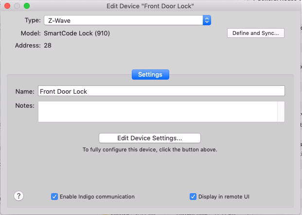

Was there ever any resolution to this problem? I just ran into it when I wanted to add a temporary contractor code for someone to replace my AC system that died. None of the get/set user code actions work on any of my 910s, and the variables to detect which user locked or unlocked the door are blank, although the lock/unlock times appear correct.

Have you got a dummy lock device pointing at it?
Devices > create > Zwave lock manager > Something?
