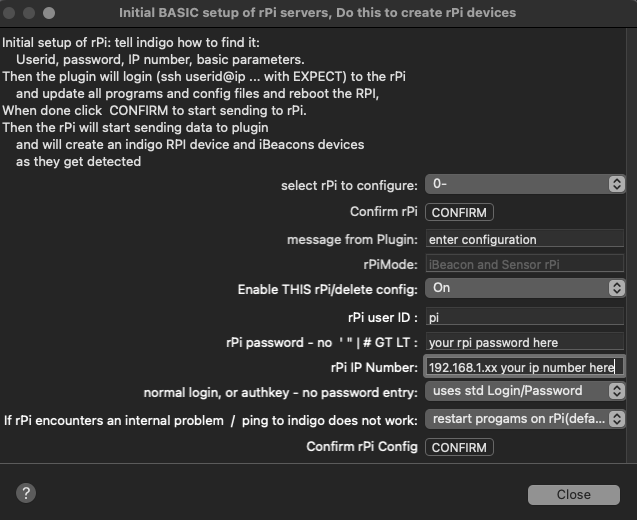

do select your ip# (0-20) click confirm
add userid password etc (make sure the password on the rpi is the same here (and change from default!! ( with passwd on rpi ) click confirm, then close

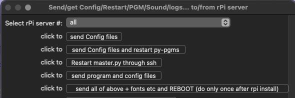

then
select all
and click on "send all of above + ...."
Screen Shot 2021-07-09 at 08.49.35.png (31.01 KiB) Viewed 3286 times
wait a minute
ssh to rpi
cd pibeacon
cat parameters
ls -f /var/log/pibeacon
post output (mask userid etc) or send email to karlwachs at me com
