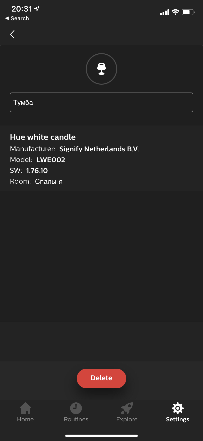

That probably means the plugin doesn't yet recognize the model ID of that E14 bulb. I can add support, but I need more information from you. A screenshot from your mobile device showing the light details in the Hue app along with whether the light supports color, color temperature or just dimming. See this post for an example of what I need.

It supports dimming only. No color or temperature settings.
Here is a requested screenshot:

Great! Thanks. I’ll add support in the next patch update.
