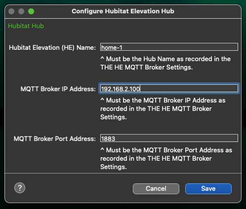

On installing the plugin, you need to create an Indigo Hubitat Elevation Hub device. Do this by creating a new Indigo device with a device type of Hubitat and a Model of Hubitat Elevation Hub, then specify required details:
Hub Config
Hub Config
As you can see the plugin supports multiple Hubitat Hubs. The plugin connects directly to your MQTT broker.

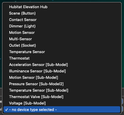

Create a new Indigo device with a device type of Hubitat. select the Model type you require:
Device Types
Device Types
You should only select models which don't have a [Sub-Model] suffix and if you do you will get an error message to that effect.

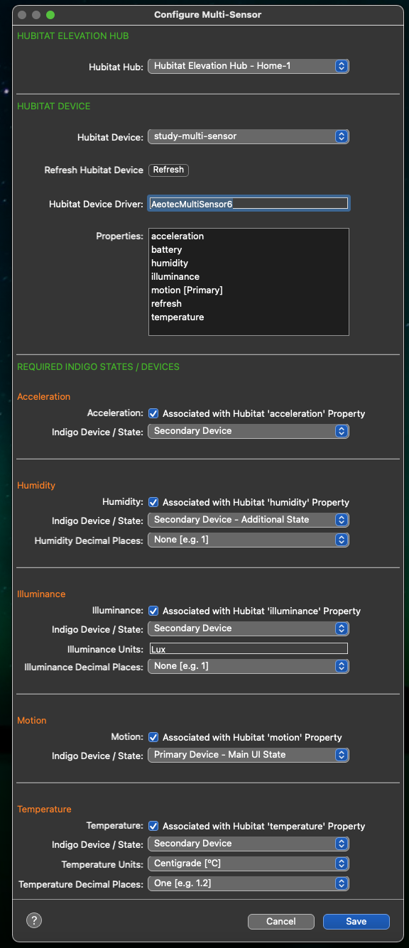

So for example selecting a Multi-Sensor will give you a Configure Multi-Sensor dialogue e.g.:
multi_sensor_1
multi_sensor_1
... continuation ...
The above example is already configured.

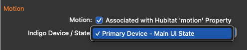

For each property that Hubitat exposes (as listed at the top of the dialogue), if supported for the device type, you can enable or disable the required states. For each state you can specify from a selection: The Primary Device Main UI State, An additional state on the Primary device or a secondary device. The Primary Device Main UI State is locked to the state related to the chosen Indigo device type.

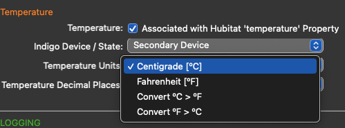

For each state, depending on its properties, you can set options e.g. for Temperature:

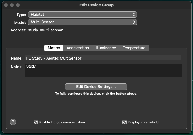

This is the resultant device listing:
