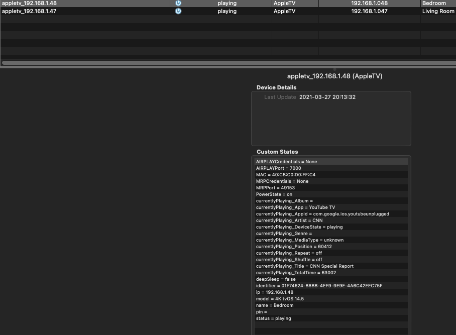

This plugin will read apple tv configs, settings, what is playing etc.
A next version it will also be able to set parameters ..
Each apple tv will create an indigo device type AppleTV

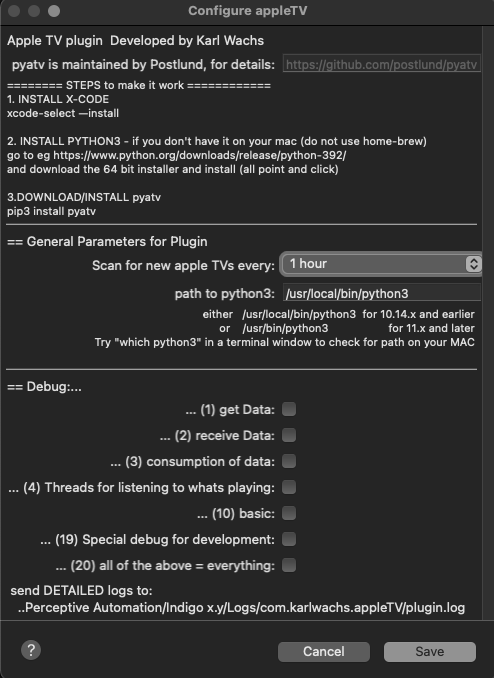

=== you need to install
1. install x-code, in a terminal window
xcode-select —install
2. install python3 (do not use home-brew) >>> if you don't have it already on your mac<<<
after Xcode install you might have python3 also installed
test with
which python3
and/or
python3 --version
you should get something like this if it is already installed
mini-09:43:15 indigo 22:which python3
/usr/bin/python3
mini-09:59:51 indigo 23:python3 --version
Python 3.8.2
if not:
go to https://www.python.org/downloads/release/python-392/
and download the 64 bit installer and install (all point and click)
3. download /install pyatv, in a terminal window
pip3 install pyatv
In config you only need to set one parameter: the path to python3. It is set to "/usr/local/bin/python" by default
