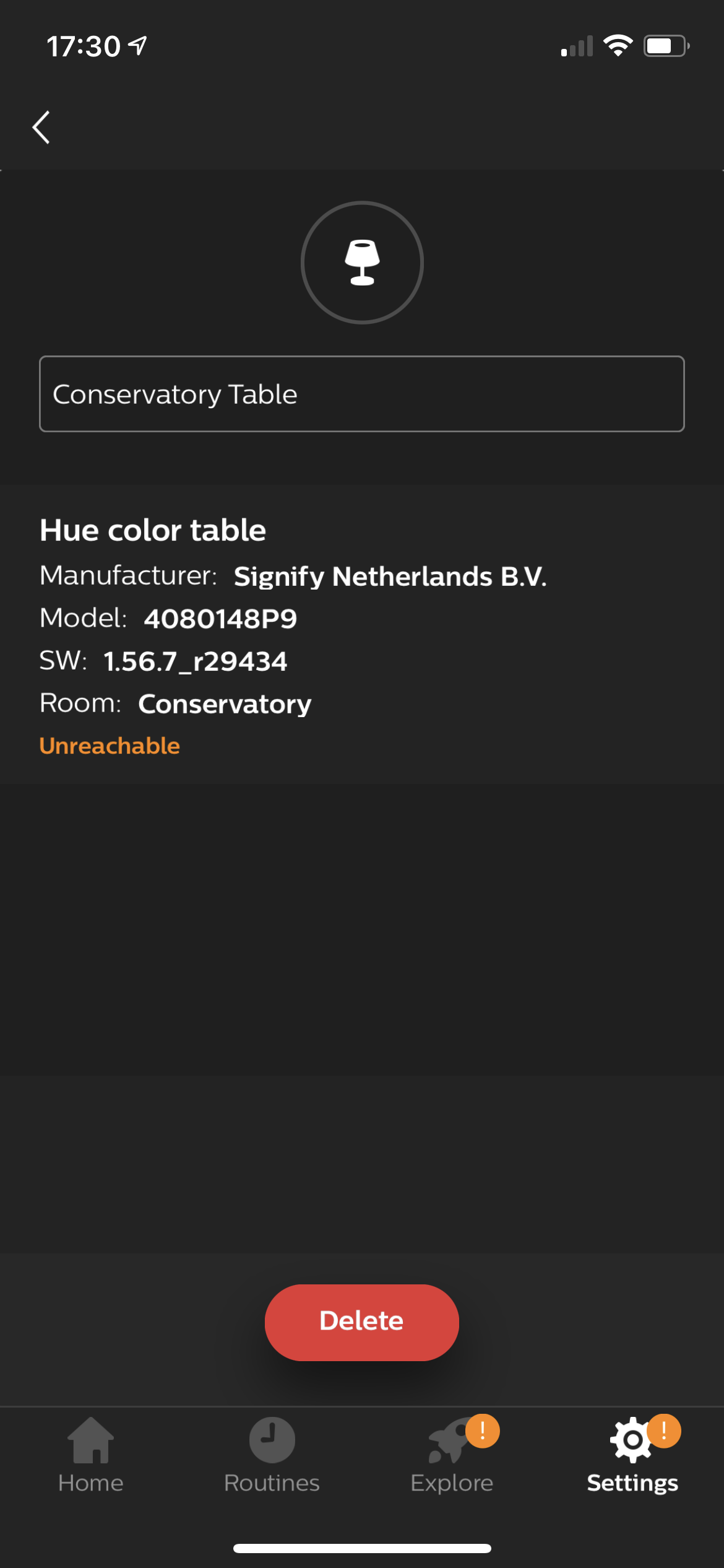

Thanks for the report. Philips don't provide details on new products any longer. So I need to know what capabilities the light has as well as the exact model ID. This can usually be obtained from within the Hue app on your mobile device. A screenshot of the new light details that shows the Model and device type and name would probably work.

I've attached a screenshot from the app - its a white and colour ambience product if that helps
Model ID: 4080148P9
Here is a link to the Philips product page https://www.philips-hue.com/en-gb/p/hue ... /4080148P9
Model ID: 4080148P9

Perfect! Yes, knowing that it's a color and "ambiance" (color temperature support) light does help. Thanks. I'll add it to the supported-devices.py file in the next patch release of the plugin. I'm glad you were able to add it to that file and verify it's working as well. That's helpful.
